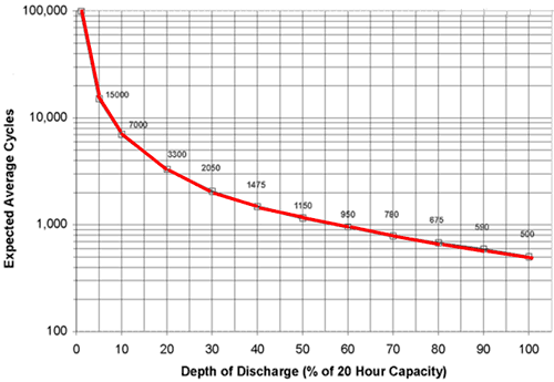

I figure I average 4 nights at the cabin a month, or what would be 4 discharges of a deep cycle lead acid battery. Call it 50 discharges per year.
Per the attached graph i'd get 700 cycles if i took it all the way to 30% power (70% discharge). That's 14 years worth of cycling!
Problem is my inverter shuts off at 10.1v, or what i believe is 50% of battery. Any way to customize that on a lower end inverter?
