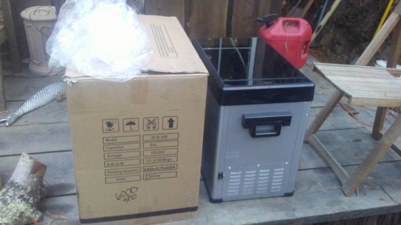

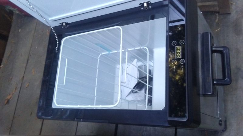

You have probably heard about the planned power outages out here on the left coast. So a co worker bought this dc cooler in prep, then decided he didn't need it and gave it to me yesterday, still in the box! The spec sheet says 2.3a at 12v, 55 watt. Does that compute?
Could have sure used it this summer, not so much now. 1015191458_Burst01.j.jpg

Its prob more like 2.3a at 120v. Does it have a transformer on the plug to get it down to 12v?
# Posted: 16 Oct 2019 03:20pm - Edited by: ICC
Reply Quote
The box end shows 23/24 volts. So, 2.3 A at 24 V = 55 watts. At 12 V that would be more like 4.6 A ???
# Posted: 17 Oct 2019 09:31am
Reply Quote
Yes, upon closer reading they just flipped the amperage in the instructions. I would have noticed had I not been in such a hurry to brag about the new toy. It has a regular ac cord and a dc cigarette lighter plug cord but no transformer and they both go in the one socket. I wonder if can sense input and adjust?

My parents have two of these type of coolers. The specs lie. Plug it in and put it on a killAwatt meter for 24hrs then tell us what it uses.
The fact that its specs are wrong right on the box tells alot.

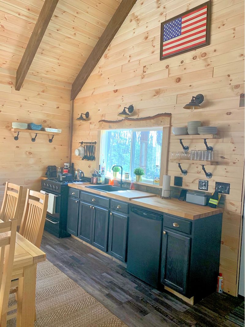

And it fits perfectly into the kitchen, under the counter top
