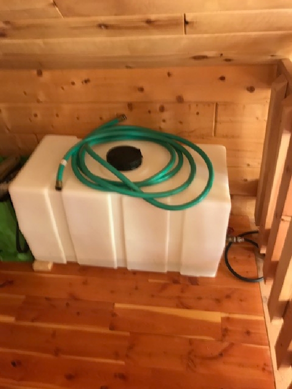

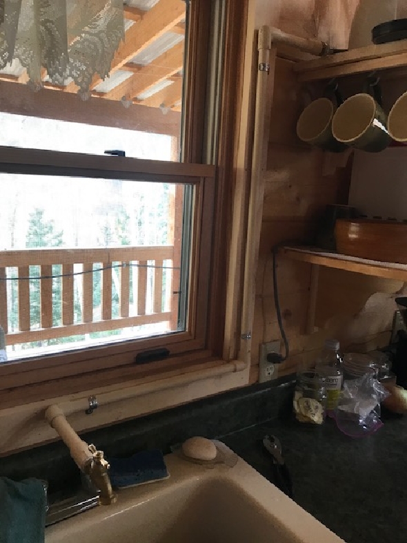

Placed a 50 gallon rototex potable water tank in the loft to fill when we are here in the winter. It is valved on the outlet then adapted to hose thread. A washing machine hose then connects to 1/2" PVC that places a faucet over the kitchen sink. (This will be cooking and washing water, we will keep drinking water in separate containers. )
We did a shake down run this morning to ensure there were no leaks and to make sure we could pump from our 7 gallon water containers up to the tank. We are using a Chugger pump (used primarily for moving wort around in beer brewing processes and a bit finicky sometimes) to move the water up to the tank. A 7 gallon water container with a faucet screwed into the lid where the spigot normally is, connects to the pump via another washing machine hose and then a 20' hose (that's what I had) connects to the pump discharge and then used to fill the tank. The Chugger pumps need head to work properly so the 7 gallon water container is set up on the counter.
Worked like a charm! Draining the hoses without making a mess was a bit of a challenge but accomplished. We will haul 4 - 7 gallon water containers from the spring (a mile from the cabin - the rest of the year we use a 550 gallon cistern filled about every 3 weeks using a 125 gallon tank on a trailer to haul with) with a sled towed by our snowmobile. Two to three trips and we should be set for a week or so.... we will use this water for toilet flushing as well unless I can find a cheap outdoor propane burner to melt snow with.

Nice and simple, You may want to support that valve a little more, the plastic doesn't like being stressed sideways when your turning it on and off
# Posted: 14 Oct 2019 03:02pm
Sparky.... yep have been giving that some thought. I noticed right away that could be a problem. Thinking maybe an ell bracket screwed to the window frame then either duct tape or snap tie it to the PVC.
