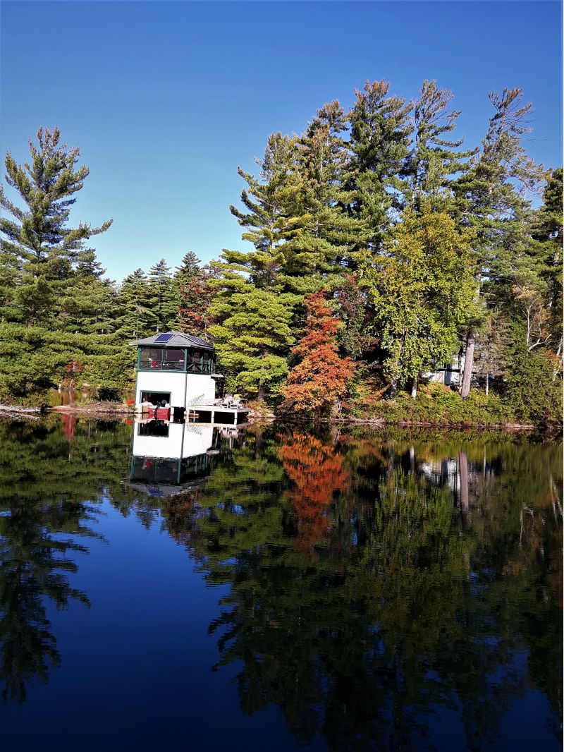

I have a Midnight Solar MS4024 fed by 9 panels on the roof of the boat house.

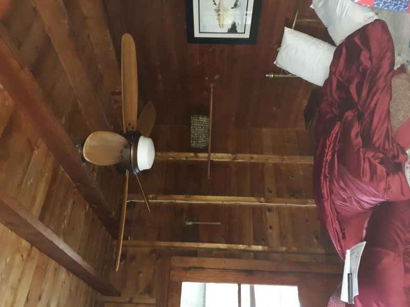

I have about 30 lights and 6 fans powered by 110 running DC motors...

Here is a fan

That is 140 year old pine in previous picture!

Old 1880's lumber managers house that somehow ended up here from an abandonded lumber camp

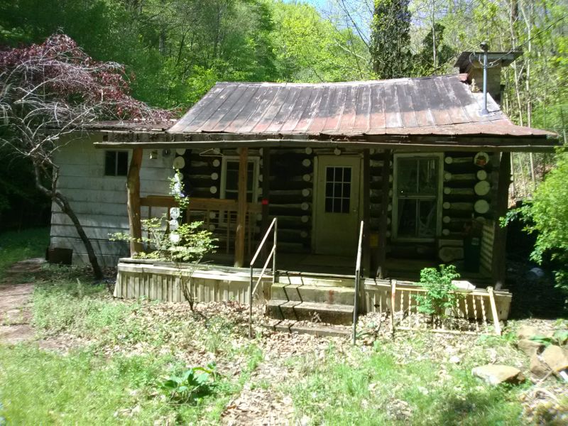

Guys I'm reading this and wondering now if solar might be good direction for me. I have a 1000 square ft cabin I'm restoring. Its located in West Virginia. Electric is available, but have not hooked anything up yet. I will retire there in few years. My wife and I will heat and cook with natural gas. But lights,fridge ect will need power. Our estimate of electric bill is 125$ month. Is it worth going solar? And where does a novice find best info? I added picture of cabin for size reference.
