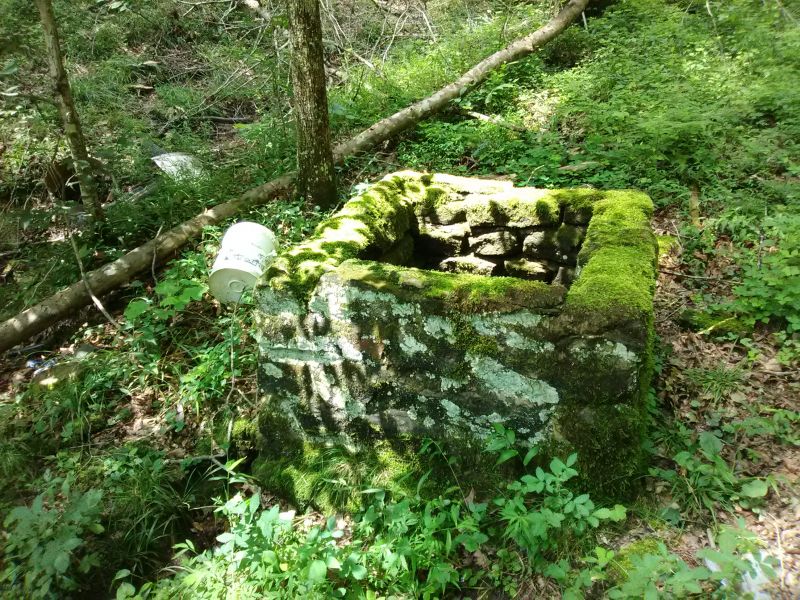

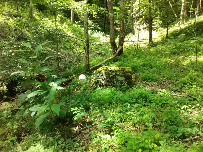

I have been asking tons of questions here lately. And the help given is greatly appreciated. My next question is do I try to use well( after draining and letting refill) or just start over. It is hand dug. 25ft deep and played up in sandstone. It holds water year round. Thinking maybe spring fed. It is 300yrds up hill, so I think can start with 1in and be at 1/2 inch by time reach home. Having plenty of pressure. I know testing tells all. But is it worth time and energy. IMG_20190703_143323..jpg

Will you install a pump? What are your water Requirements? Pipe is cheap, keep it all the same size. 1†should work depending on how much water you need.

Why start over? If the water is fresh its water. Improve it, flush it, shock it, flush it again and if your going to drink it test it.
If you can do gravety feed do 1in minimum. If its got to be pumped you can use smaller. 1/2in would be to small.
I recently got the water system hooked up at our property. 240v pumps from a stream to fill an IBC tote at the top of our small hill. IBC tote fills in 35min of generator run time. The water then gravety feeds down to our build site. We get really great pressure and ran 1in black poly everywhere. We used one 500ft spool and one 100ft spool. Total price with 240v jet pump, plumbing pieces, pipe and two IBC totes was under $650. Nothing was bought used becids the IBC totes.
