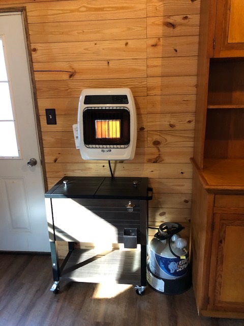

# Posted: 22 Nov 2019 06:38pm - Edited by: mj1angier
Installed our ventless heater this past weekend in our 300 sq ft cabin. Gets it nice and toasty. But if it gets down to 25 3-5 times a year so, lol We do have CO2 alarm and venting.
