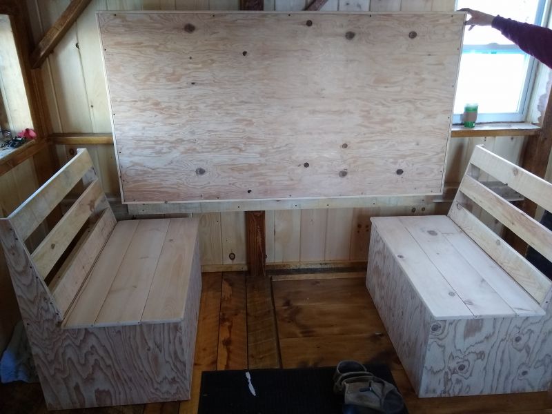

Soon I will be hooking up a small solar system to my cabin. I will be using 4 or 6 golf cart batteries wired in series-parallel in a 12v system. The battery's will be stored in an locking plastic container with detachable lid, which will be inside an enclosed but not sealed bench which supports my Murphy bed. I plan to put a 2" PVC pipe on the side of the container going out the wall and up to the roof line.

Batteries do give off hydrogen and oxygen when being charged and that is no danger when the space the batteries are in is well ventilated. I would not call a box, as pictured, well ventilated by a 2" pipe unless it was forced ventilation by a fan blowing outside air into the box with an exit that freely allows the movement of the air.

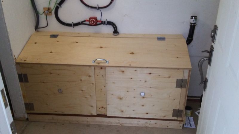

Active venting while charging, especially if the batteries are in a box is important. A Battery box which has an angled lid allows the hydrogen to rise at which point a power vent can blow it out, you only need a small air intake to allow some air in to not create any vacuum.
I use a Zephyr Vent for my FLA Battery Box but there are other ones out there for less as well, there really isn't much to them. I used 1-1/2" ABS plumbing pipe to set mine up and 2 "small soffit vents" for the air intake.
REFS: http://zephyrvent.com/
https://www.homedepot.com/p/Master-Flow-2-in-Resin-Circular-Mini-Wall-Louver-Soffit-V ent-in-White-6-Pack-RLSC2/100090036 ** I bought 1" ones and used two on the low end of the box, cost me $2 If I remember.
Here's my Batt Box when I was building it, see the two little vents in the doors. Side pipe with fernco coupler, where the Zephyr got installed.

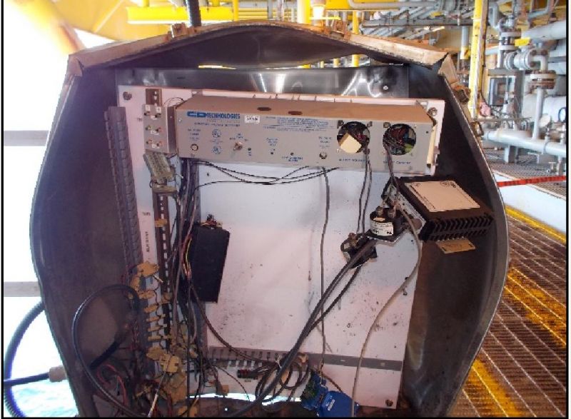

here is the aftermath of an overcharged battery in a sealed enclosure. The overcharging created hydrogen gas which if vented wouldn't have been a problem but seeing that it was nonvented it became a Class 1, Div. 1 area and either heat or sparks from a component inside ignited it. Parts and pieces where found 40 feet away.
razmichael
# Posted: 18 Nov 2019 02:19pm
Sparky30_06 - that's a good example of another design feature that can further reduce any risk - keep the electronics separate from the batteries just in case something goes wrong with the venting.
