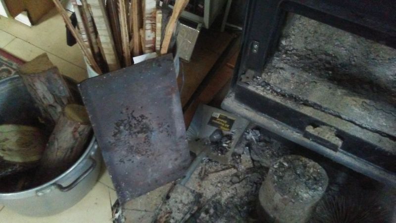

I ran a brush down my stove pipe yesterday and of course it got stuck at the bottom and had to remove this heavy plate that sits at an angle 2-3 inches under the top of the stove. I'm sure it's there for a reason and shouldn't be run without it but I recall other stoves without.
Stops hot embers going up the pipe? Stops top of stove from getting too hot? The only benefit of not using it would be packing more wood in at night, which would be nice.

I am sure it depends on the stove but the baffle in mine allows for the secondary burn. There is a great forum called hearth.com with many knowledgable members. If you post there with your stove make and model I am sure someone can help you

The more time the fire stays in the stove the hotter the stove output. Use the baffle.

Ah yes, the secondary burn..makes sense.

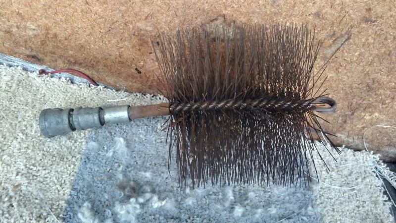

Here's the brush I used. Tight fit. Pipe is 6" double wall, straight all the way.

Thats a steel brush? Steel brushes are for masonry chimneys. They can really damage metal chimneys.
https://www.northlineexpress.com/how-to-choose-a-chimney-brush.html. about 1/4 the way down the page with the first pic of the metal brush.
