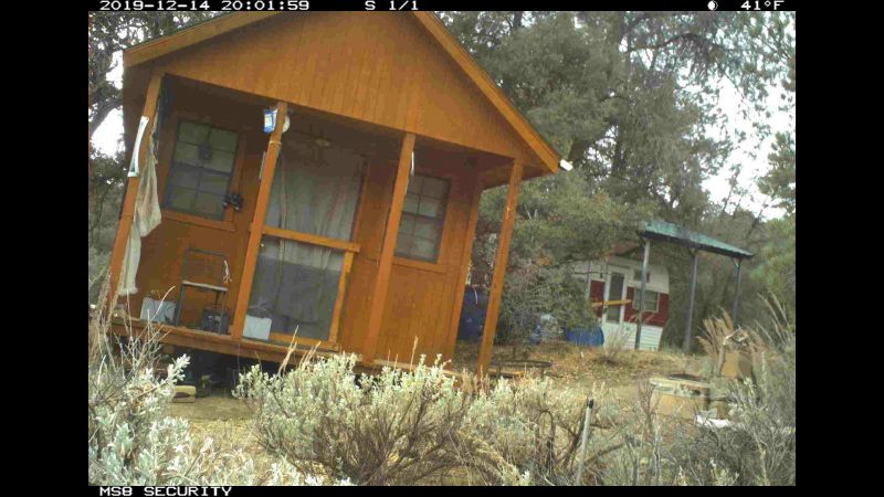

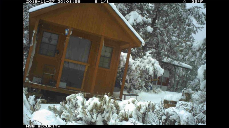

My cabin has Zero cellular coverage due to mountains and I have no access to electricity so this seemed my best option at the time..
I have to admit that after one year of actual use it has proved its worth to me through peace of mind.. I can ensure my place is still locked up and see snow conditions, as well as the temperature...
Its satellite based and $60 a month but for those of us with NO cellular or electricity it is an option...It saves me a 4 hr drive to check on things so that right there covers the monthly price...I run it with a 50wt solar and a 12v battery...

Unfortunately this is only a still photo system and it is not internet capable...it basically just uses the satellite to send out the pictures...since I use a simple 12v battery any long term snow on my solar panel will kill off the battery, even though it doesn't use a lot of energy but with the 50wt panel it reactivates as soon as it gets sun...thats not an issue for me since I know if area is snowed in then slim chance of thief being up there also..

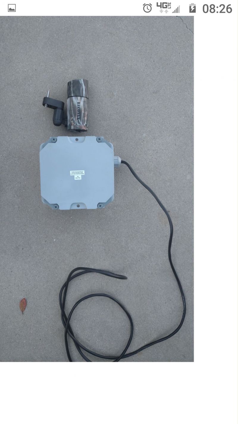

This is the system.

I dont have internet at my place so I couldn't use an internet based cam..As far as the satellite transmission,,it is all a by-itself-stand-alone transmitter,,,the system is the grey box and it is what send pictures to satellite..
the camera is a wireless bluetooth Reconx micro-fire game camera ..no wire between cam and satellite box, just bluetooth...
you just connect the wire to the battery and use phone app to set it up and once connected it is ready...you do have to do initial set up in town where you have cell coverage/internet, but once that part of product set up is done you can go full off grid...mine has been at cabin for a year without issues..
I don't know if the company has any new plans by now, but when I got this one I chose the $60 month plan which give you 40 picture transmissions, which is why I do one a day and that give me the option to command the camera to take other pics as I may want them and not go over my plan...i think its like $2 a pic if you go over your plan, so motion sensor is not the best option for this system if you put it outside...
Thru the website I can send camera to take a pic anytime I want, though it seems to take about 30-40 minutes between sending command and receiving the photo....I just do that if I want to check for snow before I drive up...the daily picture works to ensure no one has broke in the front door...
You can connect up to like 5 cameras and from my understanding it will transmit a collage of the pics so I guess you could put one inside the cabin also since they are wireless..
