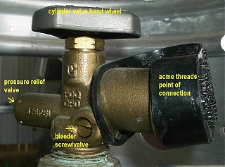

# Posted: 17 Dec 2019 06:15pm - Edited by: ICC
a picture says a thousand words
Most new tanks I have seen come with a sticker on the valve knob that states the tank must be purged when being filled.
bleeder
bleeder

I have quite a few 20lb tanks (about 24) dates all the way back to the early 90s. They all have a bleeder screw.
