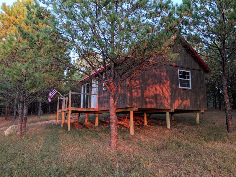

Hi everyone, new member here. I recently purchased an 18' x 24' cabin that is currently off-grid, although i plan to run electric to it. i've inquired about a well for water but that looks like it's going to be cost-prohibitive. the cabin is a weekend getaway for my family and not a primary residence. I'm leaning toward going with an above ground cistern instead of the well. since i'm in central ohio, the winter weather is something i have to take into account. Has anyone ever had any experience with installing cistern tanks indoors? I'm thinking of building an outbuilding close to my cabin that i'd heat to maybe 50 degrees or so through the winter months. as long as i place the tanks in a way that the water delivery truck can fill them, is there a downside to doing something like this? Photo of my cabin is attached.

Wow that’s deep. Tank could be a hold over but I am sure it will get old quick. If you went the tank route why not put it under your cabin and enclose it. Looks like you have plenty of room on one end.

hadn't thought about that. that might not be a bad option. my main concern is just making sure that the tanks don't freeze in the winter. it might be a kooky thought, but i thought if i located it close enough to the cabin (or now maybe under) i could actually put a vent from the cabin to the enclosure where the cistern is, using the heat from the cabin to also keep the cistern enclosure warm.

I have a friend here who has a pair of 500 gallon spheres buried under his cabin. Most of the tanks are deeper than frost depth and that helps keep it from freezing even without any auxillary heat. They do have insulation sheets above and part way down the sides, like an upside down box. Heat from deeper down rises, the insulation traps it and the water never falls below something like 50 F.

In our area of Colorado many of the folks put their cisterns under the cabin, but.... they have a perimeter insulated foundations. The water never freezes under there. It would maybe be possible to skirt and insulate the perimeter and accomplish the same thing.
