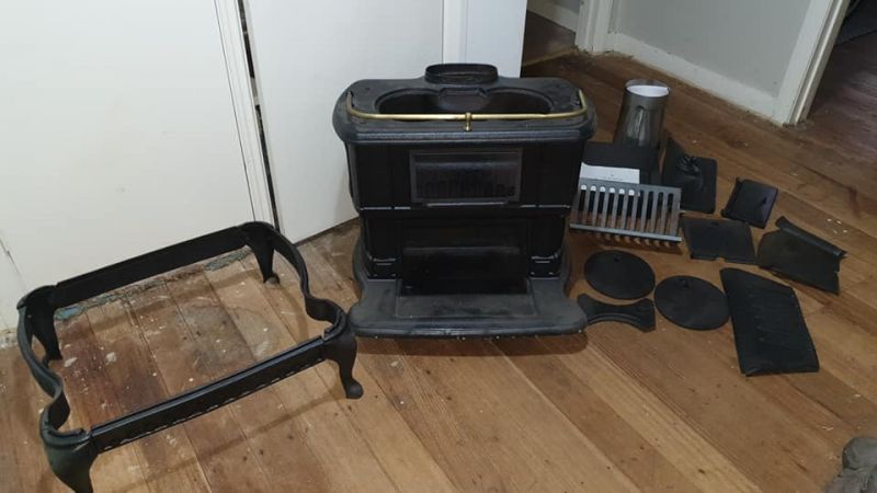

I have been offered this little stove to heat a small room. I have no idea what to pay for it or if it is any good, or just an ornament. I have heard about reproductions of cottage stoves. Does anyone know about them? How much should I pay for it?

I wouldn't... it's worth $100 as a plant stand. There are plenty of used stoves on CL etc. I picked up a nice Jotul for my camp for $125. Got another 2 for free, that people just wanted out of their house over the last 40 years.
# Posted: 27 Jan 2020 04:50pm
That thing looks pretty darn old. At a minimum you would need to replace all the gaskets in it, all of them.
If you need this inspected or to meat codes it's only use is a plant stand or boat anchor.

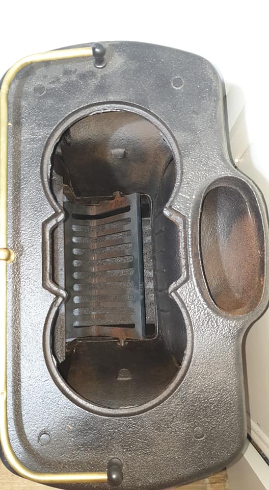

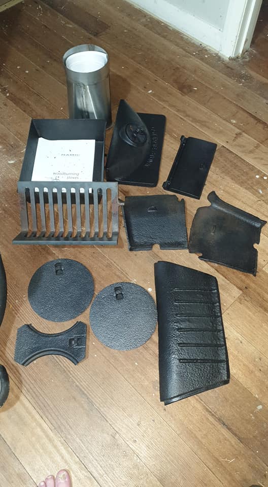

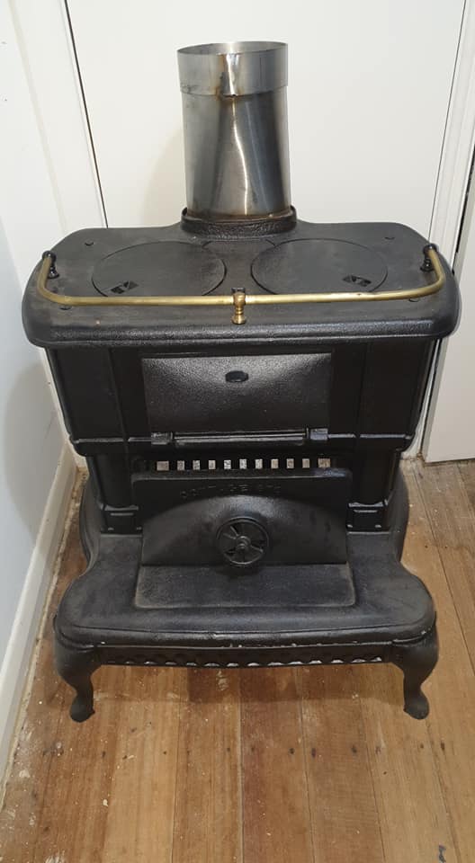

So the guy who has offered it to me, says it has been professionally restored and I have photos of all the parts, that look like they have had work done on them. Does that make any difference? 82260710_31859402547.jpg

No it prob still has no UL listing or clearance to combustables chart. Insurance company's won't like that either.

One of the most important and dangerous items you are going to purchase for your cabin is a heat stove. Don’t cheap out on that. A friend bought a used wood burning stove that had cracks. You may not be able to see them until you fire up the stove. Yes, cast iron can crack. Many reasons why, you can Google it to find out. The stove cracked open while in use. Thank goodness they were right there when it happened. Imagine what could have happened if they had put a log on and went to bed. Not only that, this stove is probably not as energy efficient as newer models and if you have insurance on your cabin the company may not allow you to use a old, used wood stove.

That stove probably isn.t an airtight. Look for a UL approved model. They are not cheap. You will burn half the wood. Equally important is a proper chimney and stove surround, behind and under. We have pacific energy stove , will hold fire all night , not hard to control.. I would pass on that stove. Good for out in the yard, to burn garbage. old 243

From what I can see, it isn't brick lines and I highly doubt it is airtight. I see a manual so there aren't many antiques that come with a manual. It is likely a cheap copy of an antique. This is kind of like a wood stove that TSC sells for $200.
Like other have said, I would pass and do more research. In recent years the EPA has mandated a lot of changes on wood stoves being sold. And there's a lot of excellent stoves out there.

Note this stove has a cooktop. Because it's a "cook stove", it's exempt from the EPA regulations for new wood stoves, a loophole used by several manufacturers of cheap wood stoves.
I would consider a stove like that if it was only to heat a small room for short periods of time... you'd be feeding it constantly as it doesn't hold much wood, no way it will run all night.
