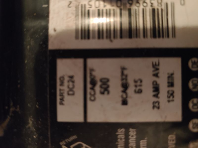

Hello my friends. I have 2 12v marine master batteries and a 500 watt inverter. Right now all i have at the property is generator power from an old rv. Its expensive to run so im hoping to charge these batteries and take them with.
About how long will 2 12v deep cycle batteries last running a laptop a blue tooth speaker and cell phone charger?
The calculators online give me a head ache. Just looking for a ballpark figure.

A better list One lamp with led bulb 9 watts i think. 8 hours per day One laptop. 40 watts 14 hours per day One speaker bluetooth watts? Maybe 8 watts?8 hours per day 2 cell phone chargers maybe 6 watts 8 hours per day

Based off of your battery pic it seems like its rated 23 amps x 2.5 hours, so 57.5 amp hours? Two would make for 115AH then. Your usage looks to be just under 800 watts a day, so that would be 66AH (WH ÷ V) I'm not sure your cell phone chargers need to be going nonstop 8 hours a day but that's your call.
You'll have power loss due to efficiency from your inverter too. And you won't want to run your batteries past 50% depth of discharge.....so I'm guessing the two batteries being used responsibly for long term life would be useful for less than a day?
A lot of other people know more about this than me, my calculations might be wrong, but if your batteries are rated for less than 60AH each I don't think two of them are going to be enough for your usage.

Those battery have a CCA rating. There not real deep cycle battery and will not even like 70* discharge. If you must use them you should really get some kind of charge on them while at the cabin. Solar or a small generator.
Jet.com has these very portable and light 1000w inverter generators for $200. There very quiet and I'm getting 8-9hrs on 0.5gal of fuel. There so quiet that at the end of a 50ft cord you almost can't hear them.
