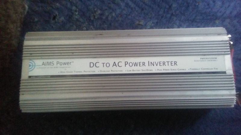

I got this unit and have had it on line for about 3 months: https://www.amazon.com/gp/product/B07PHPBMCG/ref=ppx_yo_dt_b_asin_title_o04_s01?ie=UT F8&psc=1
I used it to run cirular saw, table saw, ac, ....
It's hooked up to a 24v Lifepo4. It has worked great so far. It is a China product and directions were a little wonky but not bad. My Lifepo4 battery came from China too so I told them what charger make and they were able to give the setting for lol

This is what I have now, and plan to try some power tools today. I have some old saws and drills, no big loss.

Maybe not the best inverter for running tools but I bet it will work! I don't think you will hurt your tools.... if they don't like the power this delivers, don't use that tool with it. I think you will know right away.

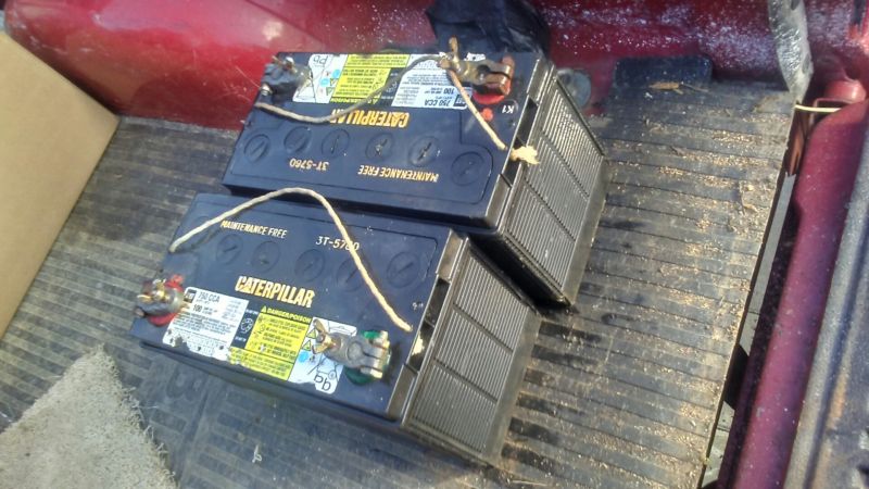

I did learn something yesterday when I ran a circular saw off the inverter. The group 24 deep cycle lead battery went down to 11 volts while the saw was running. It's hooked to a cheapo 100w HF solar system, gets an hour or two of sun on a good day but will charge the battery when I'm gone for a couple days. 11 volts was low enough to kick off the charge controller, which is hooked to the 3 LED lights that come in the kit, plus a USB powered radio and baby monitor charger I'm swimming in those lead batteries at the moment since we recently replaced them at the emergency radio repeater so I'm going to put two in parallel, which should keep the light on when running the inverter.

Group 24 batterys are just about the smallest flooded deep cycle battery you can get. Between there age and how many surge amps your pulling I'm not surprised your hitting the low voltage cut off. Your pulling +130a at 12v from the batterys, thats a lot of juice from a small battery. Add more to the bank if you have them laying around.

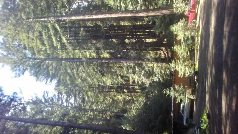

Some progress. These two Caterpillar batteries ran my cabin until I got the Valence lithiums. They are old but I charged them a couple days ago and they held at 12.6. So I just put them in the carport, wired in parallel. I put a DVM on the inverter, almost 1 amp when turned on, then went to 0. Plugged in a variable speed drill to drill a hole, ran fine, voltage dropped to 12.2 but lights stayed on.
I moved my solar panels to the front of the roof of the carport, you can see them in the photo. Best sunlight I'm going to get. 0322200843a_HDR_resi.jpg

Beautiful location but yeah... tough place for solar
