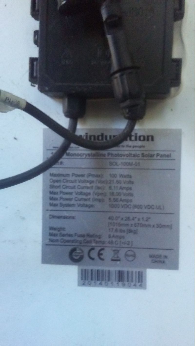

Are these the correct connectors to fit these solar panels?
Oops, thought I had a better photo of the connectors on the panel. I can take one today.

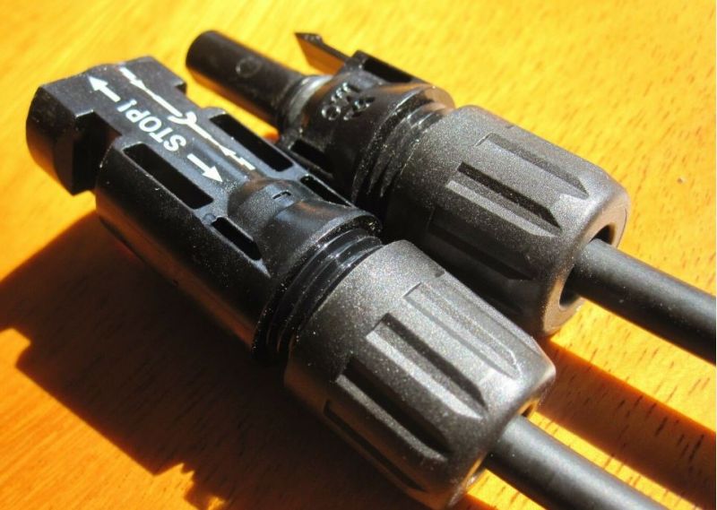

Looks like it.... you are looking for MC4 connectors. It REALLY pays to get an MC4 crimper. You can get a set.... crimper, tools to tighten/loosen connectors and a few connectors for about $30.00 off Amazon. I have crimped them using a regular wire connector crimper but it is really unsatisfactory... sloppy.

That's it. +1 on getting the correct crimping tool.

Unless you plan on taking them apart many times just strip and butt connect with sealing heat shrink.
