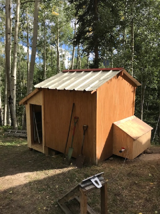

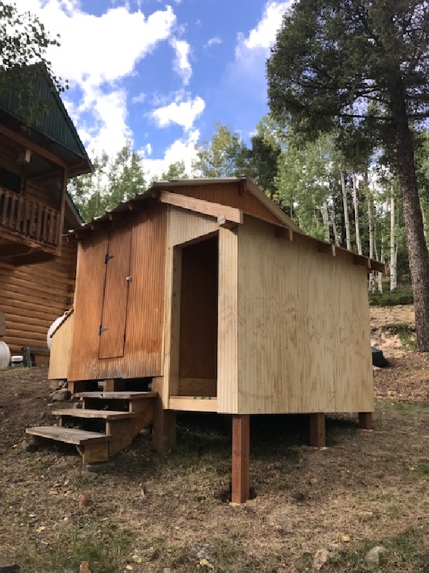

We haul water from a spring. Inside the pictured building is a 550 gallon water tank... it has been spray foamed which might help with shoulder seasons but likely no necessary. Our water pressure pump, a Shurflo RV pump is in the small box attached to the right side of the building (generator and storage on the other side). This attaches to PEX pipe buried over to the cabin. The box is well insulated as is where it comes up out of the ground and into the cabin (survived a couple of 10*F nights already this spring). The RV pump had it's own solar panel and deep cycle battery but that has been replaced with a 120vac - 12vdc transformer. There is plastic pipe, 1 1/2" with quick connects and valves so we can hook up the 1" Honda pump to pump water into the tank from our 120 gallon trailer mounted tank that we fill at the spring.
We drink our spring water, but it is tested at least once per year. As a precaution we do put 1/2 cup bleach per 550 gallon tank of water. Brett's recommendation of filter or UV is probably the best way to go from an untested source. IMG_4891_resize_70.j.jpg

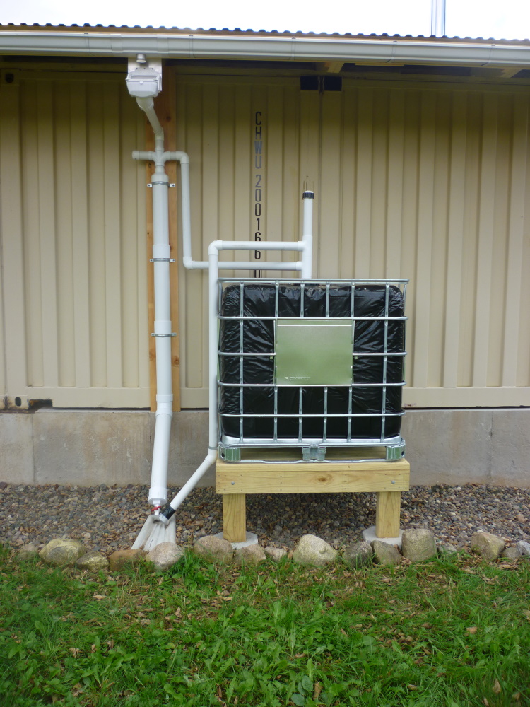

I'm also in Wisconsin and have an above ground cistern that I use in the warmer months. It collects rainwater from the roof, flows through a leaf eater screen, then into a DIY first flush diverter, and finally into a 275 gallon tote. It's worked well the past several years, and the quality of water I get has been very good. I don't use it for drinking water at this time, but I know I could if I had too.

Steve... nice looking set up!
# Posted: 23 Apr 2020 07:25am
That is very nice Steve. I see you even made provisions to add another IBC with the 4 way Tee. Very clean setup you have there.

The other outlet is actually for an underground 300 gallon spherical cistern I am planning to install someday. This will then allow me to have water at the cabin during the winter months. I'll keep the tote for extra water needs in the summer, and since it's elevated it's quick and easy to get water out of it without a pump.
