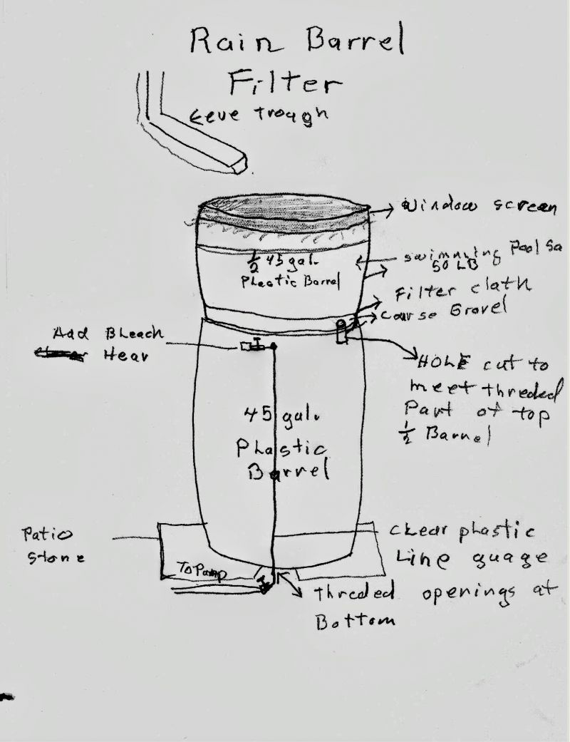

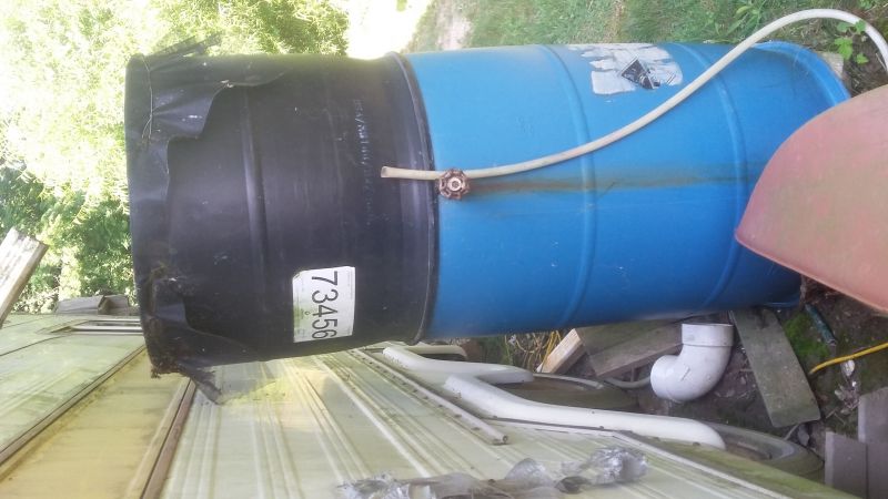

# Posted: 29 Apr 2020 08:40pm
Here is a pic of my small system.we use it for everything, boil the drinking water . Keep it in the shade and add a oz of bleach a week .symple , works,..
