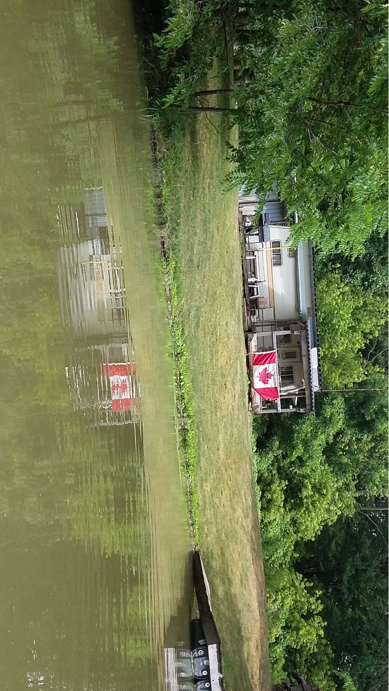

I live in northern Ontario and my trailer is farther up north in a heavy snow belt area average is 157inches. And we go get some of the coldest temps I Canada. Last winter where my trailer was it was -57 plus wind chill for a week straight and when plumbing antifreeze is only rated for -50 haha. My trailer is a 98 and it's been up there 2 winters now with zero issues. I go up once a winter to shovel the roof. I plan on keeping it there probably 2-3 more winters before I pull it out and sell it. I'm not worried about a trailer that is 20 years old. I would def not be worried about a 2014 trailer parked in the bush for a few years.
