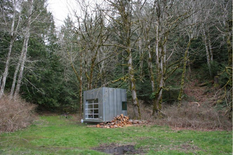

Hi there I was reading through these forums with great interest as I truly live in a very small cabin. I want to be able to charge my Netbook and my cell phone, and run 1 or 2 lights for a couple hours at night. I have a kerosene lantern and headlamps but I want to try something else. There is power on my property in some of the other cabins but they are a quarter mile away and I want to try solar instead. My budget is a megar 300$ I have seen harbor freight and I am skeptical.
Tell me is this possible!
i have attached pictures of the size of the cabin to make my point, it is small, but i love it!
Cheers! Theodore

Q: Where is this? State is good enough to get a handle on how much usable sunlight you get. Winter use or three season (more sun)?
Do you have a good southern exposure, one with no trees, etc to cast shadows on the PV module(s)?

I have great southern exposure but i do live on orcas island in Washington, we get clouds and rain, and alot of it !! Summertime though we dont get cloudy for 4 months!!
