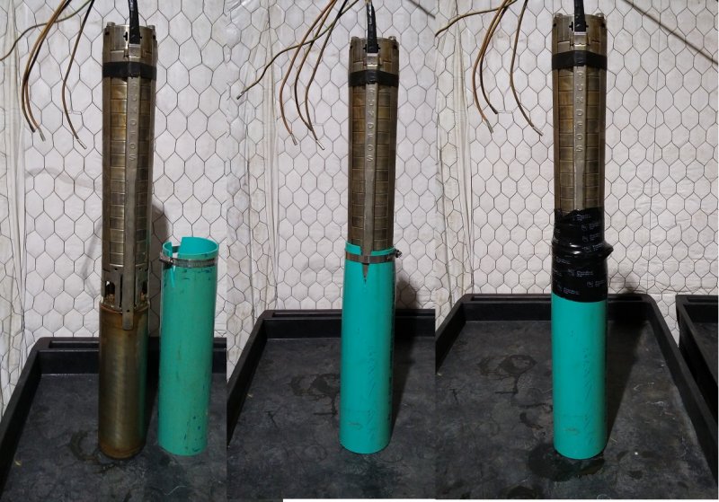

I would use a submersible pump in an flow inducer sleeve. That way you don’t have to worry about priming and elevation is not a concern.
Our family cottage in northern Ontario has been using a system like this for nearly 20 years now, we used to use a jacuzzi pump in a pump house halfway between the lake and the cottage but it was a monster to prime and get going every spring, especially in black fly season
We bought the submersible pump and put it inside a milk crate and dropped it in the lake about 10 to 15 feet from shore.....we leave it in the lake every winter and it starts up like nothing every spring...it feeds a 20 gallon holding tank we have under our verandah and the pressure is never an issue.

You want to keep your pump elevated off the bottom of the lake some how and it’s good practice to install a flow inducer sleeve around the pump to force water across the motor. You will run poly pipe and wire from lake to your cabin and install pressure tank and pressure switch to control the pump. I would install a drain somewhere on your line maybe at the water line in your poly pipe. Poly can handle some freezing without cracking but good idea to get as much water out as you can for winter. Picture shows flow inducer
