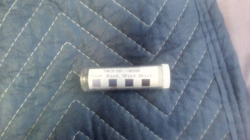

I got a chlorine test kit. Same as the household bleach I put in my water tank right? Doesn't even turn as dark as the lightest scale, 10 ppm. How many ppms is good?

I don't think that is a proper kit to use for drinking water. The water we drink should not contain more than 4 PPM. The CDC has some info online about chlorine and how to use and test.

OK, maybe it's for pool testing. Good excuse to get one.
