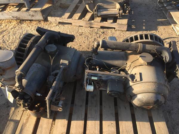

I think I want a hit and miss engine, so I'm poking around and see this. what is it? A hit and miss generator? That would be neat.
Hit Miss Engine Delco Generators Light Plants - $125

Grandad had one. Most produced 32 volts DC. There were also some that produced 110 volts and were available in AC or DC.
The ones pictured are laying on their side, the cylinder is vertical when in use. Air is drawn in the top and exits at the fan, backwards of most forced air cooled engines. But they did the job back before power lines. The generator acted as a starter motor, then automatically switched to being a generator when the engine got going.
They made about 2 dozen different models. 150 watts up to 1500 watts I think. Gasoline with some able to burn kerosene at reduced output. Some of the early ones were 6 volt or 12 volt. A starter kit with a few lights and one battery was about $250 way back in the early 1900's. About $3000 today.

ICC, thanks for the explanation. Sounds pretty neat, might have to get one of these. Do you remember hearing one run? Was it a real low rpm, the kind you could listen to all day? I'm thinking maybe a 12v battery charger? These two are only $125 each.
