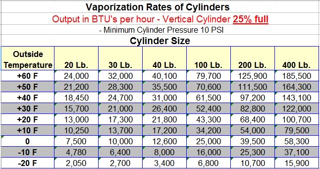

Have you checked the vaporization rate for a 30lb tank? There not really good enough for what your doing. I have a chart on what temp a propane tank can supply what BTU, il see if I can find it. I guess if you want to try it out leave the regulator high enough that you can put a 100lb tank on it.

So two 30lb tanks in parallel (pulling from both tanks at once) can support just your tankless at 60*. Unless your in the south that's a pretty poor output.

Brettny - That is a major bummer. I am trying to get confirmation from tankless company about this. Then essentially I need a 100lbs tank min??? nice that I just spent $150 on 2x 30lbs tanks and propane
According to your chart no propane tank can supply you enough btu at 0 degrees? that doesn't seem right.

I found another chart with very different numbers?

A regulator dosnt make the tank vaporize more. Your chart is for a 100lb tank and different amount of propane in the tank. The chart I showed is for each size of tank with 25* remaining in the tank. They are almost identical numbers of you look at the chart right.
I should clarify that a 20-100lb tank both have the same pressure. The 100lb tank has more surface area to vaporize this allowing you to remove more gas at a time. The colder it is the less propane you can remove at once from the tank.

btw, at 20f a 30lbs will provide 17.3k and a 100lbs is at 43.3k so that still won't be enough for max..

BTW... that chart shows that even a 400lbs tank at frozen weather won't work so this tells me that a household can't use this for main heat source if they are in cold weather like ny... wild.
