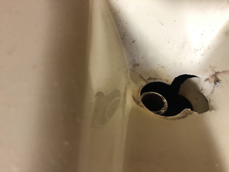

We bought a Sun-Mar NE in Jan of 2007 and the fiberglass “body” at the back called the rear bearing plate part #EN 0111B has cracked and the steel shaft for the crank keeps falling out of its “keeper” hole.

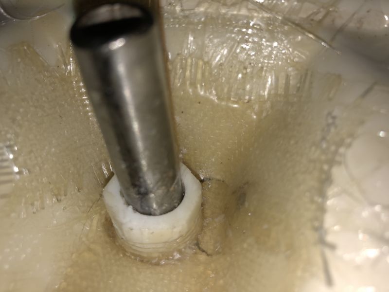

the fiberglass worked great...i had a plastic nipple in my MacGyver box that threaded into the fractured hole and had the right ID for the crank shaft....turned out great........town is 45 minutes each way so you try and find something laying around that will kinda work...in this case I had the perfect MacGyver part....shed would be almost empty if I threw out all those boxes

Id post pictures but it says I not allowed to?
Broken
Broken
Sayhey24
# Posted: 30 Jun 2020 09:48am
Not sure how I managed that!!!!
Fixed!!
Fixed!!
