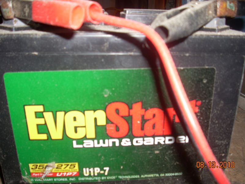

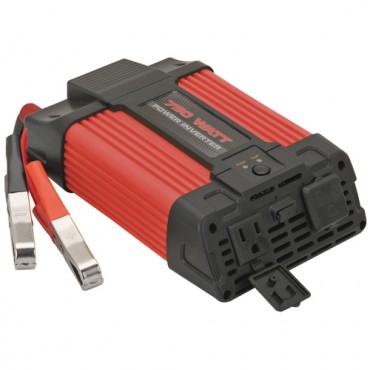

I personally used a "Lawn and Garden" 12v battery with a 750 watt power inverter. It was abe to simultaneously power 6 6w LED light bulbs, 1 19" CRT TV, 1 12" fan, and charge a cell phone. If I left all on it was good for about 6 hours. If I ran just the TV and 2 lights, I got about 8 hours of use. The TV seemed to be the biggest drain. If I only ran the lights, I would get a full night of use. I frequently had my laptop plugged in to watch movies at night, and it stayed powered on for 9-10 hours straight before the sun came up.
