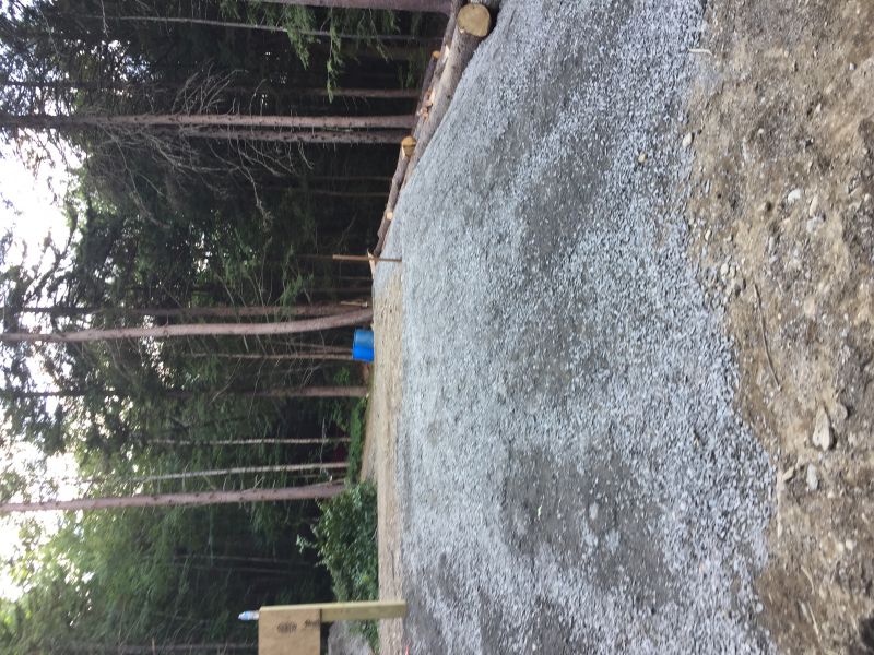

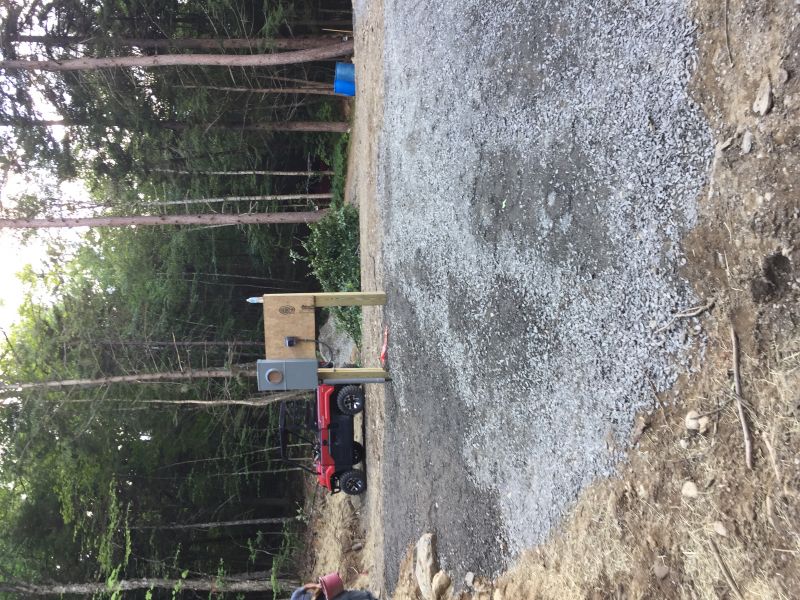

Here is a picture of the slope from where the tank sits up to the foundation. It doesn't look like there is a that much slope difference from where I am standing because I zoomed into to take a picture of the stone I used for the bank and the recently installed temporary service. I now have power! That is a discussion for another day. It is easily 10-12' from where I am standing. The inlet on the tank is 2 feet below grade. I am going to put a 2'-2 1/2' wall around the perimeter of the slab room enough for a crawl space. I plan on plumbing the main sewer line right up under and through the slab into the crawlspace. Any suggestions of how high I should bring the main line into the crawl space? I was thinking 6 inches would be good but some have suggested to go pretty much flush with the foundation floor. I will have plenty enough space for 1/4" drop per foot for inside plumbing with the use of the crawlspace. Probably leaving more would be better as I can cut it to what ever I need once the rest of the sewer plumbing is installed.

By the looks of the pic it's nearly flat. How much vertical drop between the outlet of the building and the tank inlet?

It is deceiving but as I said the pic is zoomed in and there is at least 10-12 feet difference from the gravel pad to the tank. I am going in tomorrow to get an exact measurement. I know for certain that the grade to the tank to the original spot before I put the gravel pad in was a little over 8'. About 3-4' of gravel was put in on the low spot of the original pad to bring it up to grade for the slab which I am putting in in September. I am running the main line towards the front of the pad where most of the fill was brought in which would estimate it between 10-12 feet.
