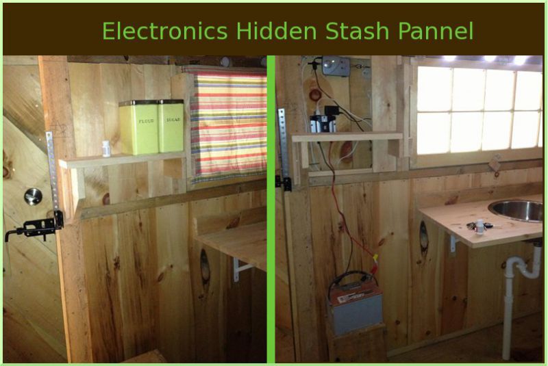

# Posted: 10 Jun 2013 09:20am
Thought I'd add a bit more to the thread, hope this is still on the topic. This post relates to staying on the Internet once connected. Enclosed is my hidden wall panel for the 3-G repeater and power inverter. If someone does get in the cabin I'm hoping they won't get notice my gear, the 3G repeater is expensive. The battery still rides in the car, for now. Had great weekend weather so there was not much need for the Internet.
