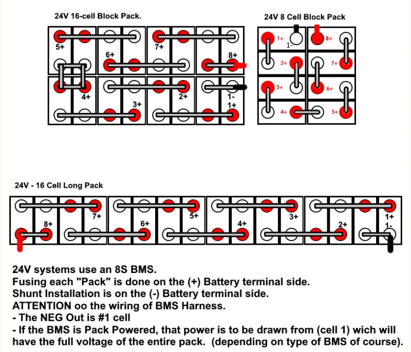

Each battery pack would require one BMS (Battery Management System) and a fuse of course. 12V - 4S battery pack would require 4 cells and a 4S BMS. 24V - 8S battery pack would require 8 cells and a 8S BMS. 48V - 16S battery pack would require 16 cells and 16S BMS
BMS: There are many types of BMS' whic have a variety of functions, capabilities, of course that is reflected in the pricing. A very "A-Typical" smart BMS with Bluetooth functionality (monitoring & configuration) will run about 150 USD. These are FET based and typically CAP at 200A output & max of 100A charge input. BMS' that handle above 200A usually use Relays/Contactors to disconnect the battery pack if an error condition arises. These tend to be more expensive but more reliable as well for heavier use. Your Needs and Wants would determine what is better suited to you application.
The BMS will monitor each cell within a pack. It guards the cells against Over/Under voltage, Over/Under Temp conditions and will cutoff the battery if the paramters are exceeded to protect it. Some BMS' have Passive Balacing while others (more $) have Active Balancing.

24V Battery Pack Assembly with Prismatic LFP NB: This shows with Paralleled Cells within a pack. This is not generally recomended with Large Capacity cells The Internal Resistance tends to vary more along with the cell capacity and through cycles. These are NOT mAh cells.

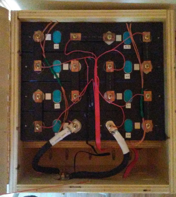

# Posted: 24 Aug 2020 05:44pm - Edited by: Steve_S
The easiest format to work with in my opinion, is the square / rectangular cells because of the busbars , wiring and "packaging" into a case or something. The info is there on Diysolarform and being so busy, it can get hard to find specifics or you get overwhelmed with info. Damned Catch-22 I think. hehehe
Here's a pic of of the inside from one of my 280AH packs. Shows the simplicity of it, compared to other types. 24V/280AH assembled into the box

It may be worthwhile to mention that prismatic cells must be encased in a tight fitting box or plates that help keep the cell walls from bulging.
