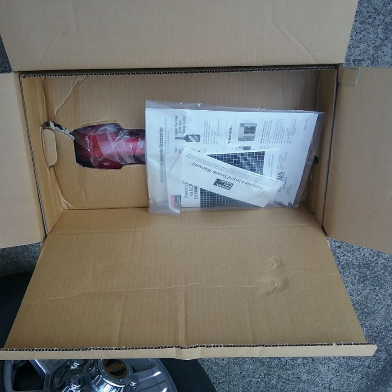

# Posted: 26 Jul 2021 11:16pm

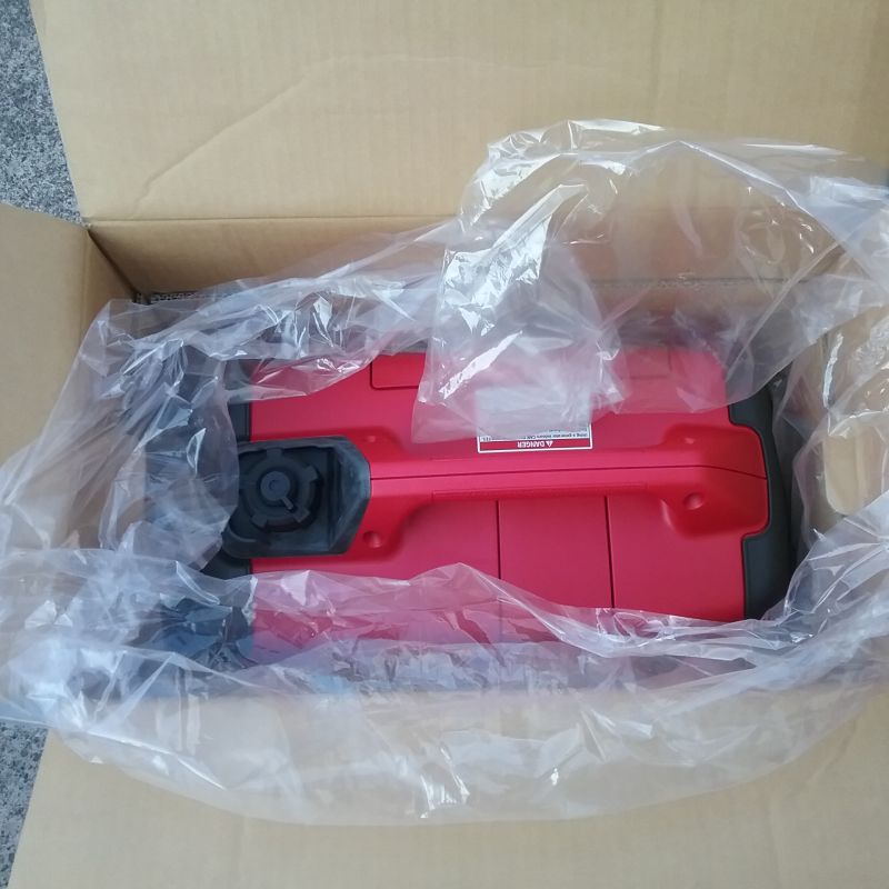

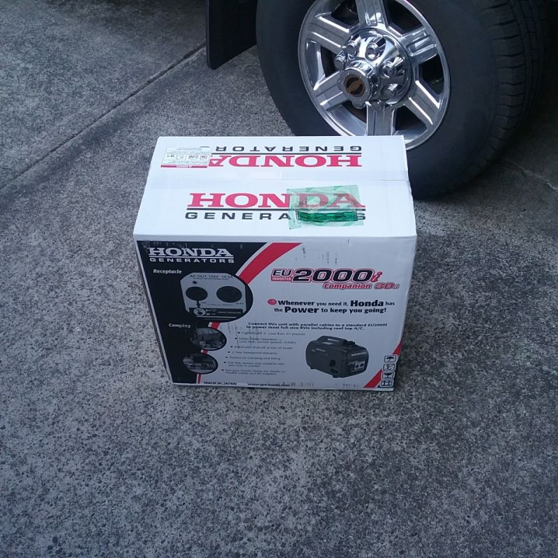

OK, finally opened the box for the first time since the factory sealed it.
New old stock (NOS) that a buddy of mine bought and never used. Its about 10 yrs old, EU2000i Companion. Exactly what I was after. Looking to get the new EU2200i companion, but no one had them, very hard to find. But remembering my buddy, I inquired and got it for $850
new in box. never opened

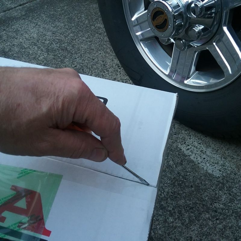

breaking factory taped seal
exposing top side
exposing top side
remove inside liner
remove inside liner

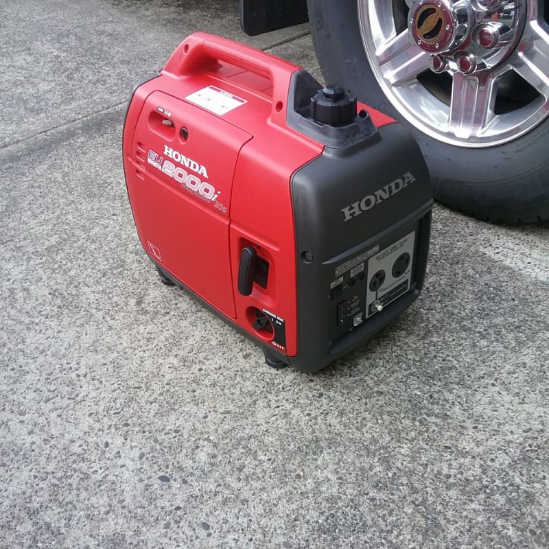

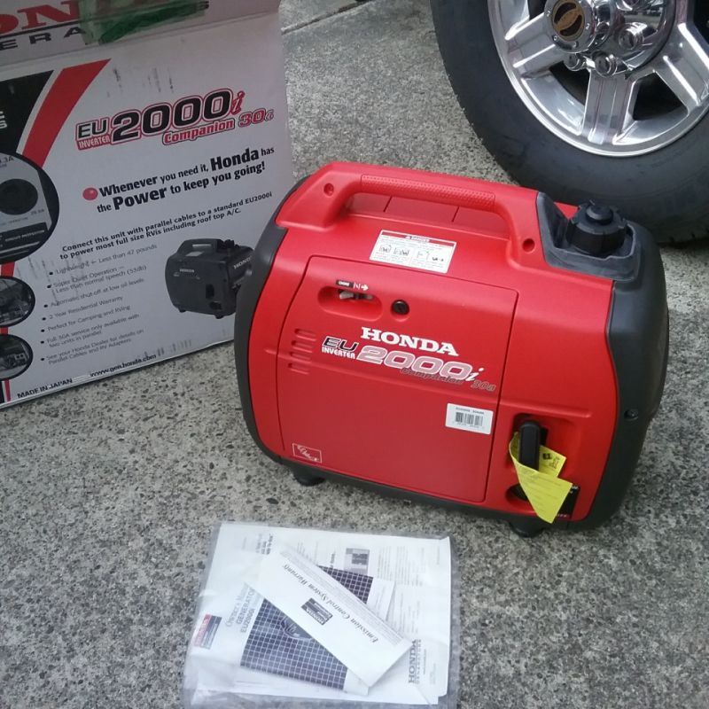

out of box
out of box
complete unit
complete unit

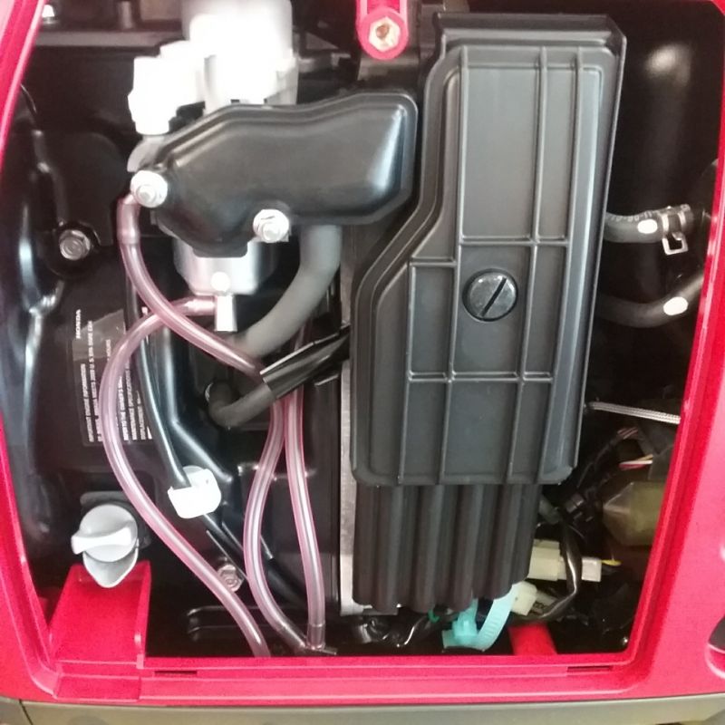

Service panel off to add Honda 10-30 oil
