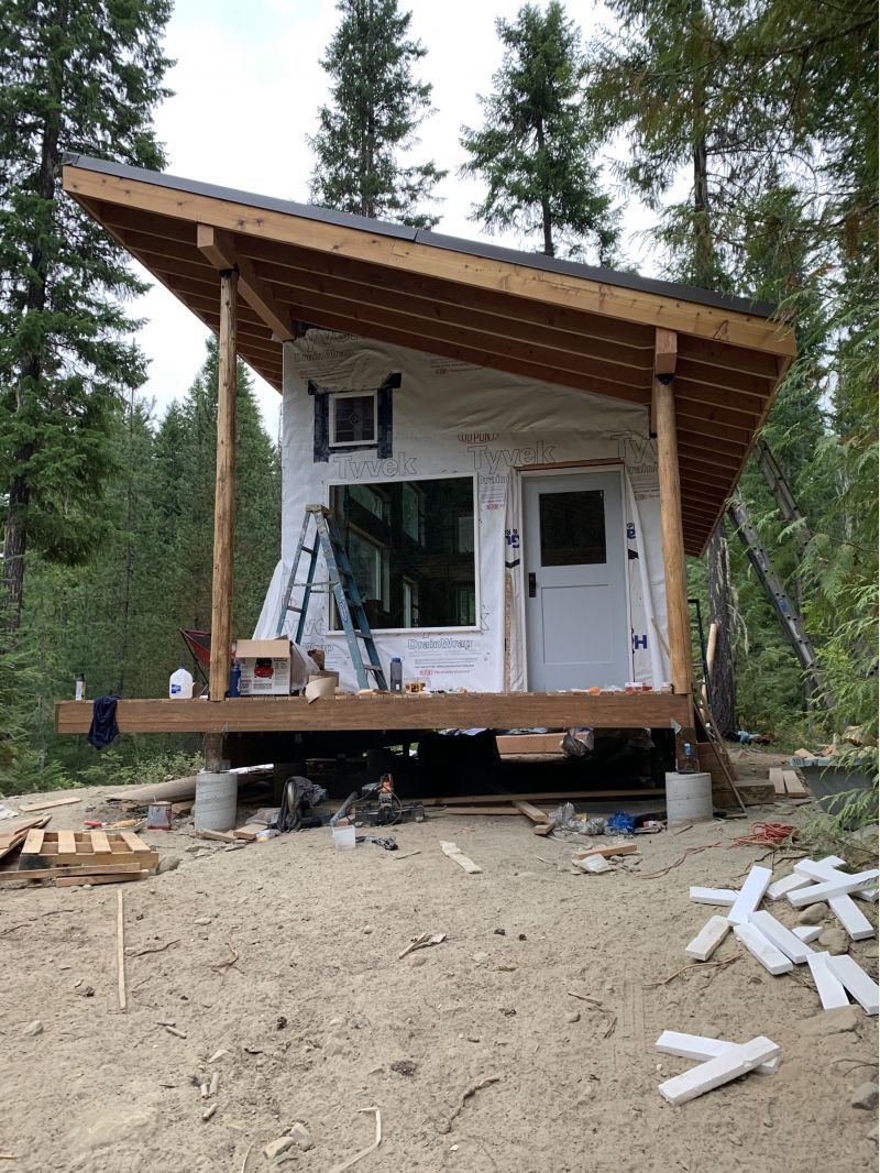

Hi all,
I am building a small (250sqft) cabin far off grid in the Washington Cascades. Cabin is going swimmingly, and I am wanting to wire for electrical now and am back from camp doing research. Initially I wasn't planning to wire, but so many folks have recommended doing it up front, that I've decided to go for it. BUT I'm just starting my research from scratch. Lots of good content here on the forum, but I'm having difficulty wading through.
Electricity needs: Handful of lights, maybe a phone charger.
Details: tiny cabin, no generator, modest engineering skills, good attitude
