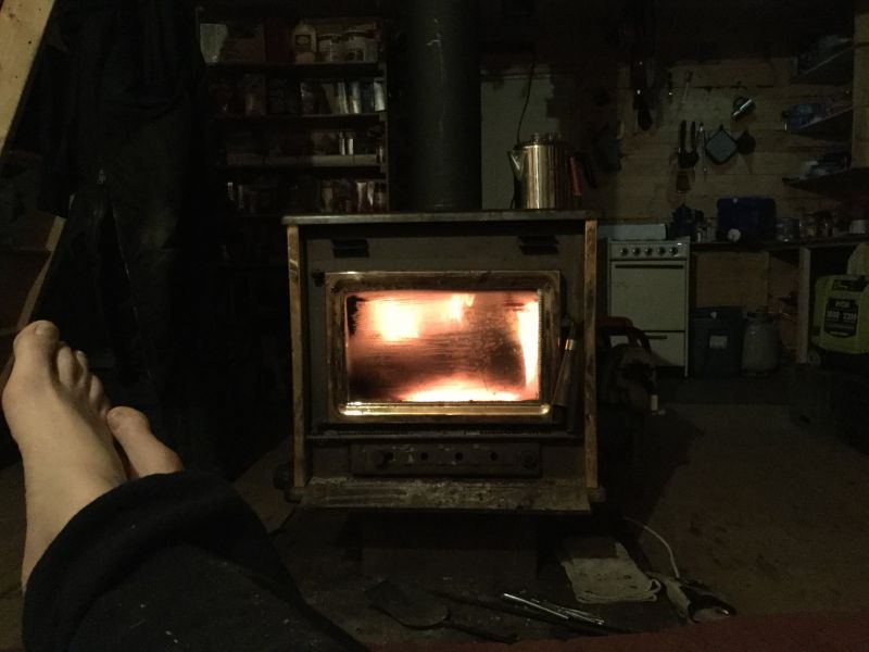

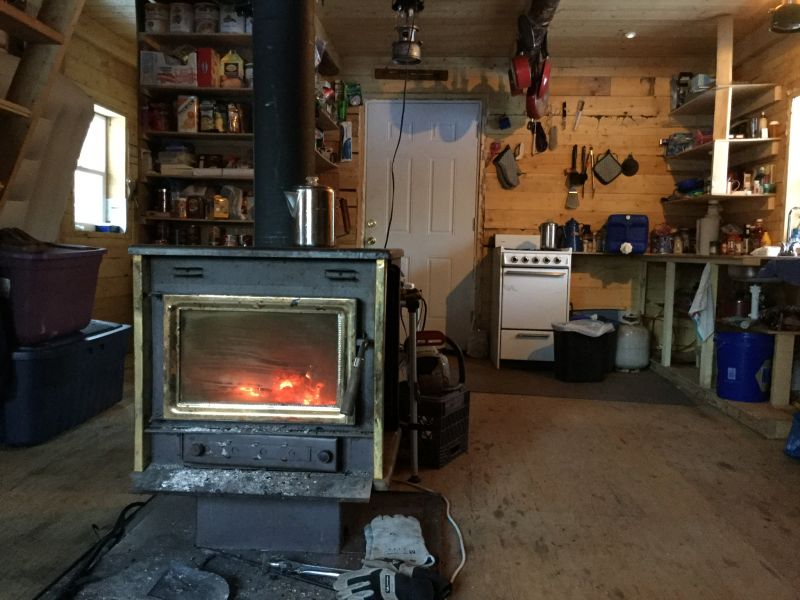

I use several brands. Probably all of them pretty good. I’m sitting next to our aspen brand I think, at the cabin right now n lovin it. 16-24 , 2 floors. The type of wood you you is probably more important. If you have access to dry oak or maple n such use that when it’s cold. Less dense woods now. Right now I’m burning beetle kill spruce. Nice n dry. Burns clean . When it’s -25 I burn birch. It’s more dense and burns hotter when needed and lasts longer. We have access to spruce n birch mainly. So last night. I fill our stove with spruce n shut it down. All air intakes closed. It will pull a draft through the bottom grates n ash pan. I try to make sure I have a bed of embers so load a couple pieces a couple hours earlier. It will last 8 hours or so. And the cabin does get warm . I open the windows or door. To me the fresh air n warm heat feel great together. Bottom line for me . When it’s cold I want to stay warm. I can deal with warm easier than cold. Get a stove that will keep your warm. Our cabin is made from log so retains a lot of convective heat. When it’s -25 for several weeks I’m glad I have birch. Or a comfortable zero outside I will use both woods. So wood species is real important. I will throw the biggest piece I can get through the door in er to get through the night. That helps. Lots of little pieces burn fast n hot. And will not last near is long. So pretty much if it fits I’m done splitting. I will always have lots more to split. Glad I only have to put up 5-6 cords a year now. My point being. Stove brand is a factor. I personally believe that stoves made by smaller shops are superior. I did custom woodwork for years n know I built a better product. I don’t believe that you have to buy from a major supplier. Factory made . Some great skilled crafts folks out their. And proud of their work. I live in Ak. I have to have enough range in heat output to get through real cold weather for a long time. And I like hangin out in a nice warm cozy cabin. Not screwing with the fire. So I have a stove that can handle the most need. Adjust the type of wood I use. And size . It’s 45 in the morning now n 65 in day. I just throw a small piece on once n a while every couple of hours. Doors open , no problems here. It’s also going to take a few years to get used to any stove. For me hot is better than cold. Good luck man , glad to see you thinking about it and researching. You’ll do ok. Now get er Done n enjoy your cabin.
# Posted: 31 Aug 2020 01:42pm
I also like a stove that I can open the door and watch the fire. Every one n a while stir the coals n throw on a log . My version of changing the Chanel.
