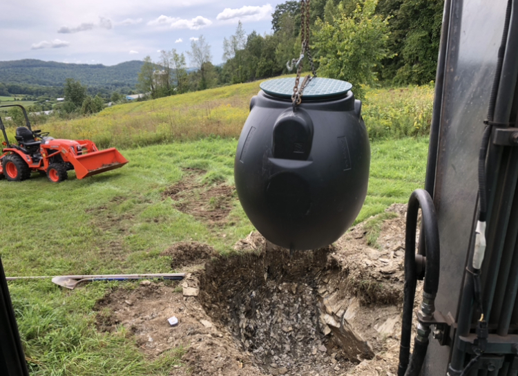

Irrigation Guy
# Posted: 2 Sep 2020 03:45pm
Found a picture
# Posted: 2 Sep 2020 04:40pm
yep. Those are made to be buried and the spherical shape keeps them from being crushed even when empty. There are usually manhole extensions available too so it can be buried deeper and retain an access hatch at or near surface level. I have used similar tanks for fresh water cisterns too; 325 gallon and 500 gallon I think.
I would be very concerned about an IBC tote collapsing or leaking eventually if buried.
