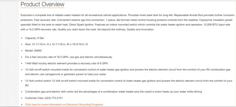

Thinking of popping for this 6 gallon RV LP water heater for the cabin. I don't get the last two items in this description. What is the 'electric element circuit', and what's this about 'coach's motor heats up while you are driving'?

# Posted: 7 Feb 2022 10:43am
Paul I believe that means it has an electric element and a engine coolant to domestic water head exchanger.

Electric heating element? Why would it need that with LP? And a heat exchanger with engine coolant would be good for an RV but obviously I wouldn't need that, unless I could pipe it to the wood stove...
Going to look for the manual. I had one of these in an RV years ago, it was simple, no electricity, started it with a match, and no heat exchanger.
EDIT: Found the manual, it does have the heat exchanger, still working on the electric element part..
EDIT again: I think that HD description includes the other Suburban models. They have pilot light, piezo spark and electric/gas combo models. The combo actually sounds interesting since I have extra solar, sometimes.
There are a variety of RV water heaters. Some only burn propane to heat, and come with either a pilot light or direct ignition that requires 12 VDC. Then there are RV heaters that also has a 120 VAC electric element for when the RV is parked in a campground with electric service. They are also a small number that have a coil of tubing inside the tank that allows engine coolant to circulate through when driving and transfer heat to the water in the tank. That uses a closed loop from the engine so the coolant and potable water do not mix.

Electric heating element? Why would it need that with LP? And a heat exchanger with engine coolant would be good for an RV but obviously I wouldn't need that...
RV appliances are often designed to run on electric as well as propane, so you don't waste propane when you're at a campground with AC power available. RV refrigerators often are 3-way, running on propane, 110VAC, or 12VDC.
