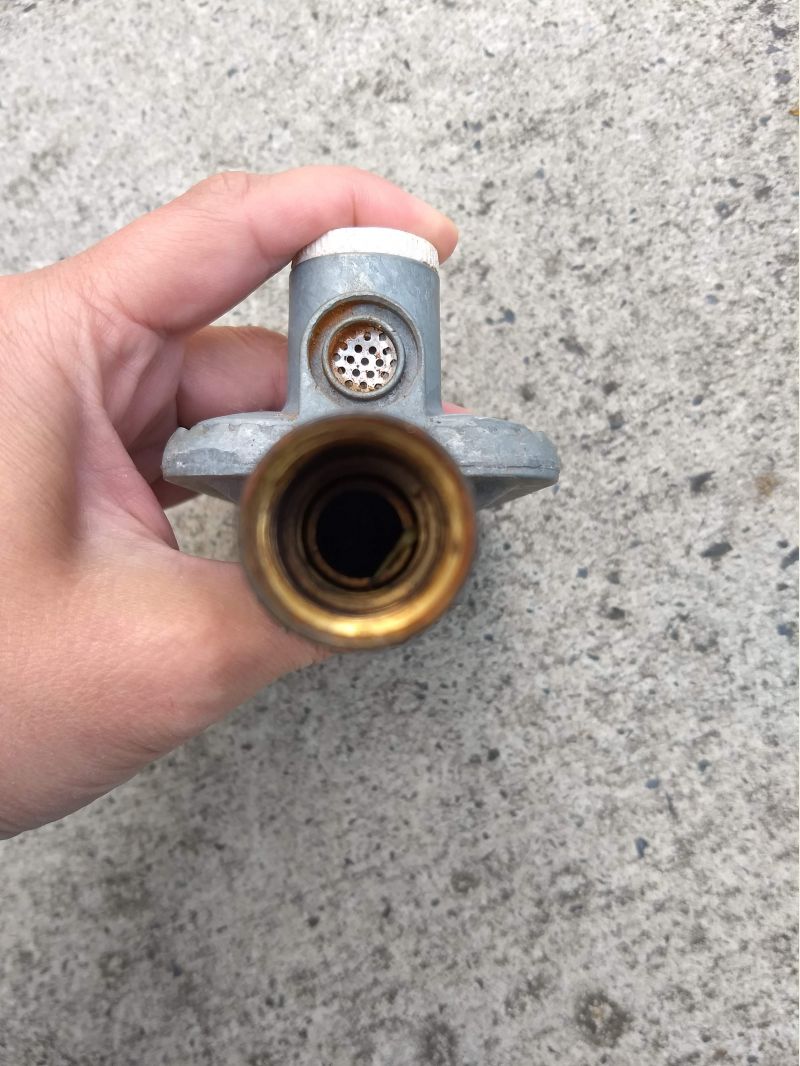

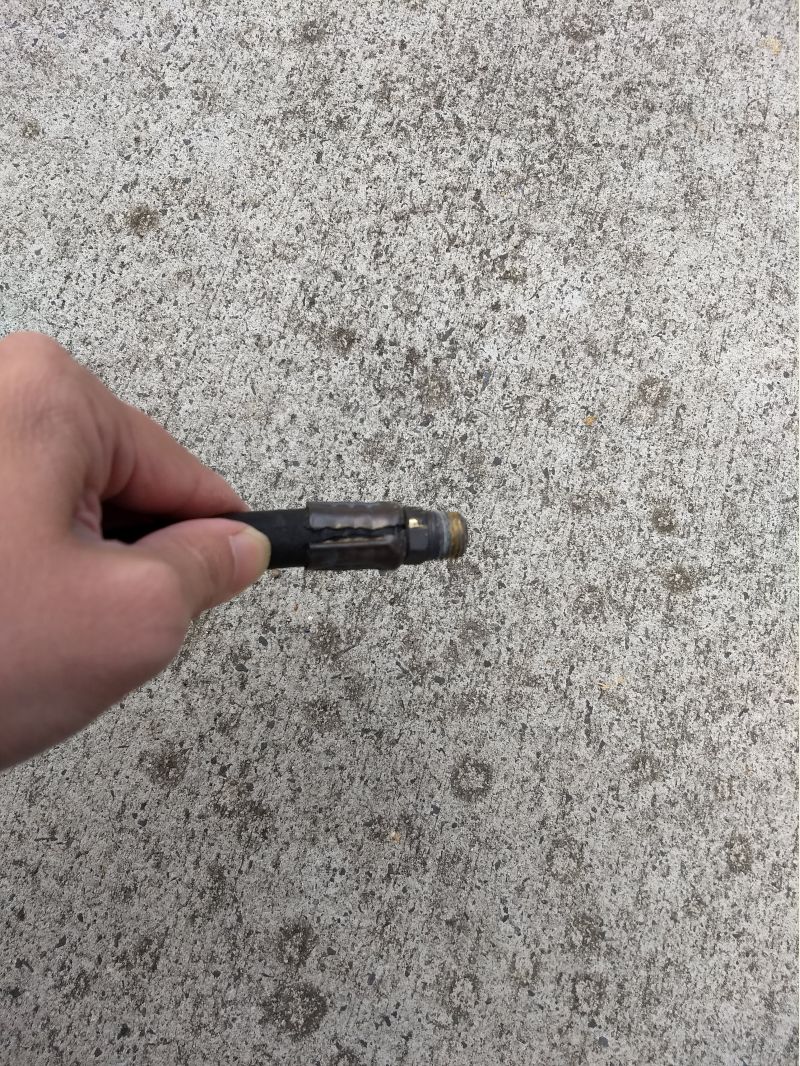

moneypitfeeder
# Posted: 15 Sep 2020 06:05pm

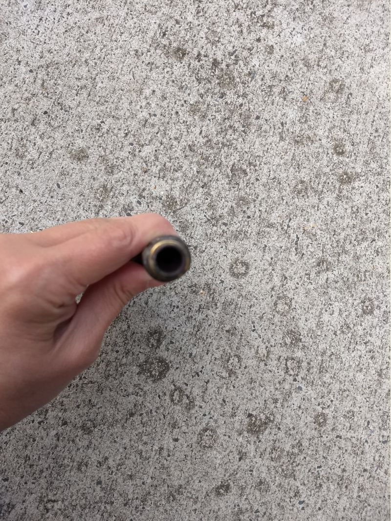

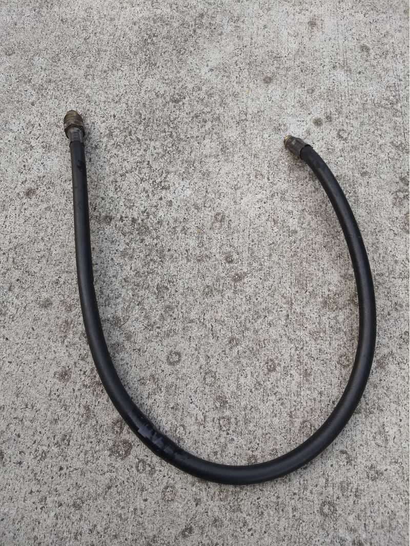

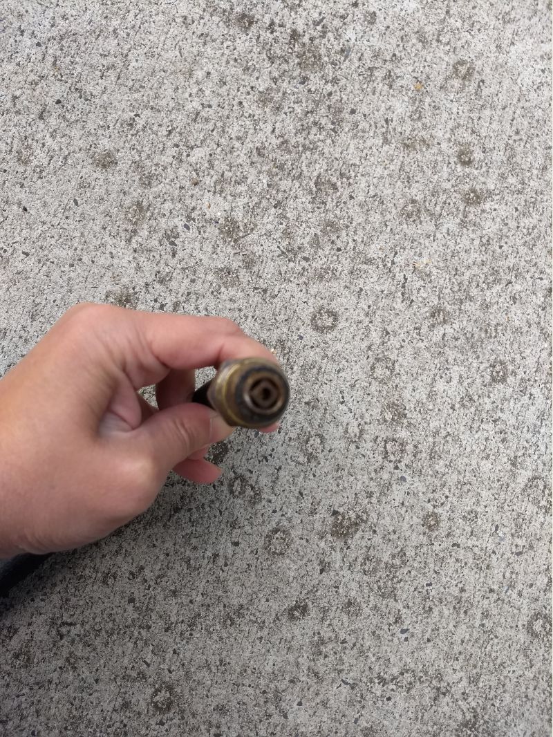

Here's pics of the current hose we are looking to replace.
hose1
hose1
hose2
hose2
hose3
hose3
hose4
hose4

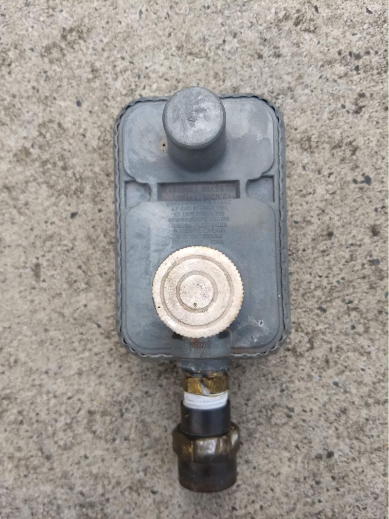

moneypitfeeder
# Posted: 15 Sep 2020 06:06pm

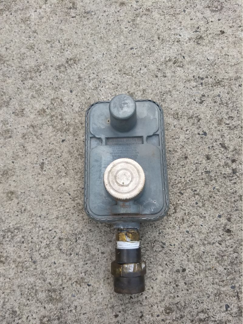

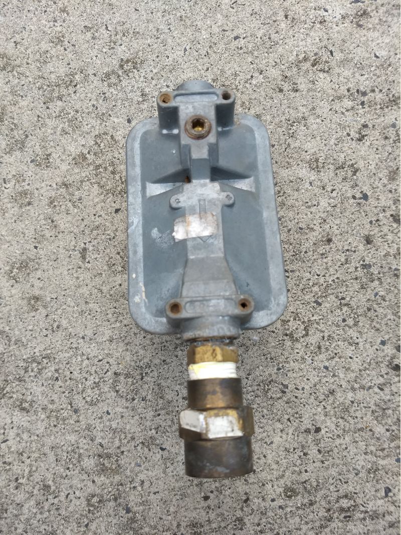

And here are pics of the regulator we'd like to replace.
reg1
reg1
reg2
reg2
reg3
reg3
reg4
reg4

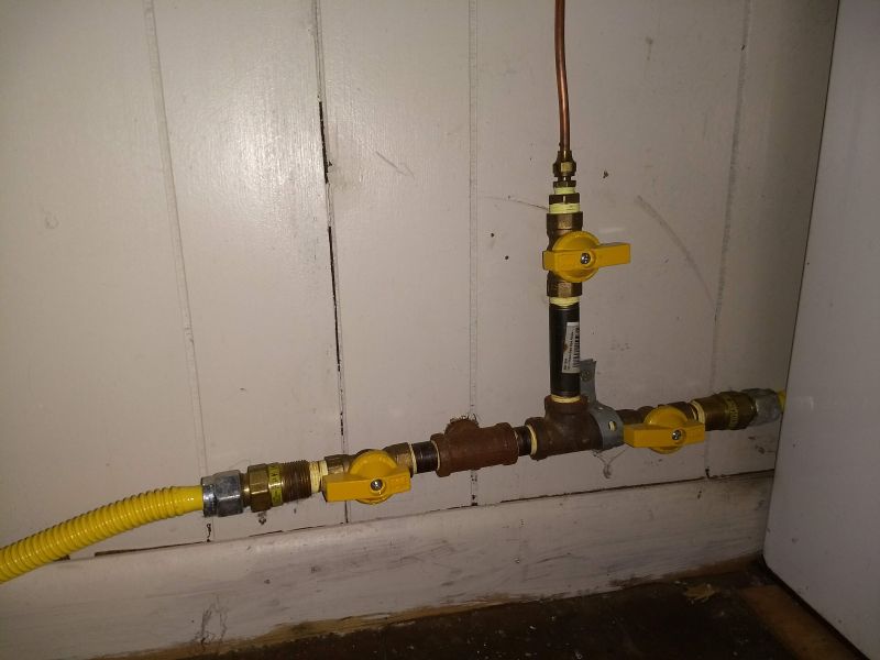

# Posted: 15 Sep 2020 06:16pm
The hose from outside connects to a black iron pipe that extends to the outside of the cabin from the center tee of this manifold, just to the left of the vertical take-off. The vertical is to the lights, the left yellow hose is to the fridge and the right is to the range that you can see the edge of in the pic.
# Posted: 16 Sep 2020 05:50am - Edited by: Brettny
Looks to be an old camper regulator. It should say 11 or 12W.C on it some where. That's a pretty standard pressure. Since rodents chew your rubber I would replace the rubber piece with a copper pigtail. Those are all pretty standard propane parts and I'm sure if you know the pipe size you could find them in many places online.
I'd you wanted to use a rubber hose again I would get one with a standard ACME fitting on the end. No tools needed to change your tank.

If you do go back with rubber, you can cover the hose with a SS braided hose sheath:

A rubber hose should never be used in any permanent installation, and is probably illegal under most building codes. And the regulator must be a two stage regulator, not the single stage regulators used on campers and BBQ grills. I got most of my propane stuff from propanewarehouse.com.

There are rubber flex lines with a S/S braided cover much like plumbing faucet supply lines. I don't think most rodents will cause any damage to them. They can still "age-out"like any rubber item though.

Regulator: This one or this one. Flex line (not a rubber hose!), one of these.
