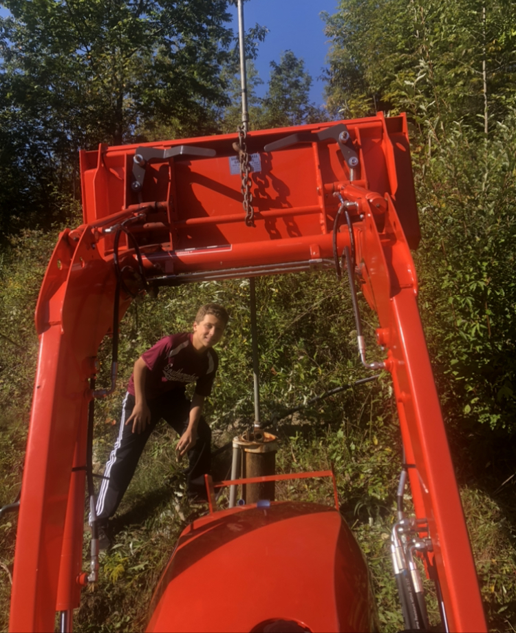

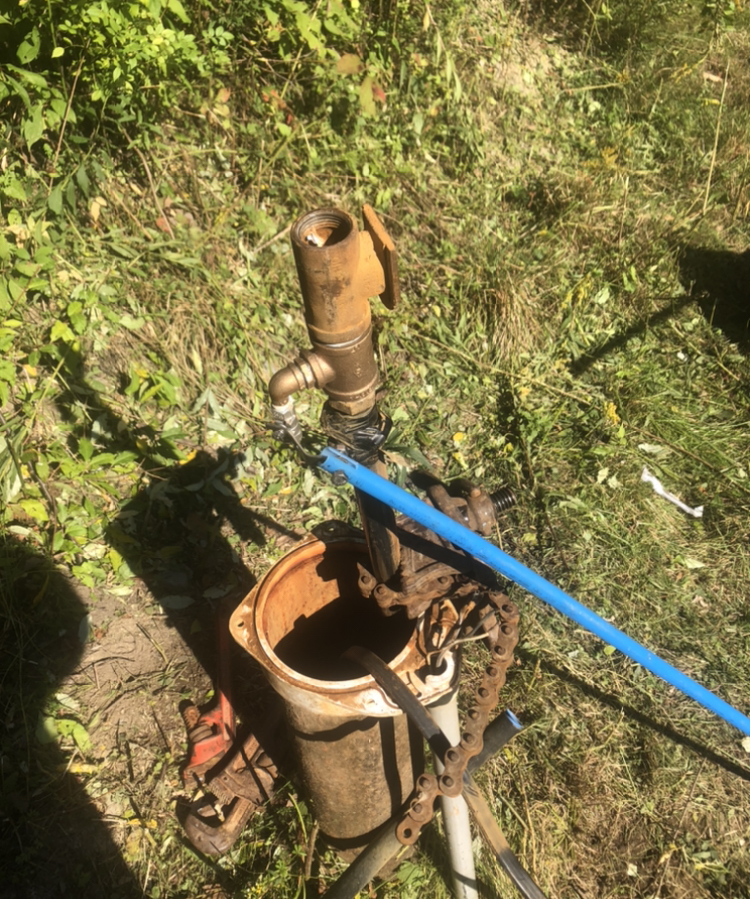

# Posted: 19 Sep 2020 08:36pm - Edited by: Irrigation Guy
The boy and I finished our drain back today. Installed 1/4 ball valve just below pitless adapter and vacuume/air relief just before the well tank. Made a Handel out of 1/2 Pex so I can actuate the valve from just under the well cap. E418A254B00D4F75B.jpeg
