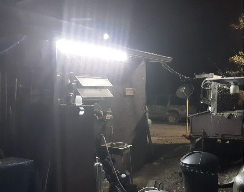

Quoting: MO Cabin I cannot find a 12 volt pull chain style socket. They have 12 volt bulbs that fit the off the shelf light fixtures.Quoting: MO Cabin 12 volt lighting will not be beneficial as the ceilings are 8-ft tall I will post a pic of 12 volt led light. My ceiling is 9 feet high.Quoting: MO Cabin My second question is about flood lights. I do not want to use motion activated flood lights I am looking for an option that I could turn the lights off and on from the inside of the cabin, do you have any recommendations They have 12 volt flood lights available. But I mainly use strings of LEDs from St. Louis lighting. I have them under our gazebo as well for the outside of the cabin. 12 volt led. 9 foot ceilin
|  Outside leds. On a switch.

Just had a second thought for your outside 12 volt flood lights. Check on amazon for off road led lights. I put a couple on my side x side that have a spot light beam and flood light beam. Got a pair of them for about $25 bucks. They put out huge amounts of light. Not just the flood lights, but if you want to concentrate the light in a certain area too. I will also post a pic of 12 volt RV style lighting in our bathroom. In the picture there is also a light fixture behind me above the sink area.
