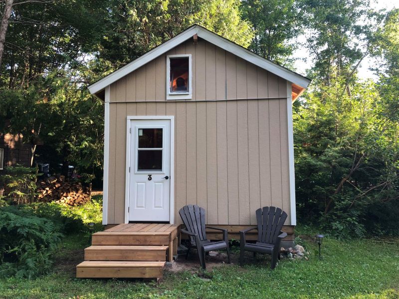

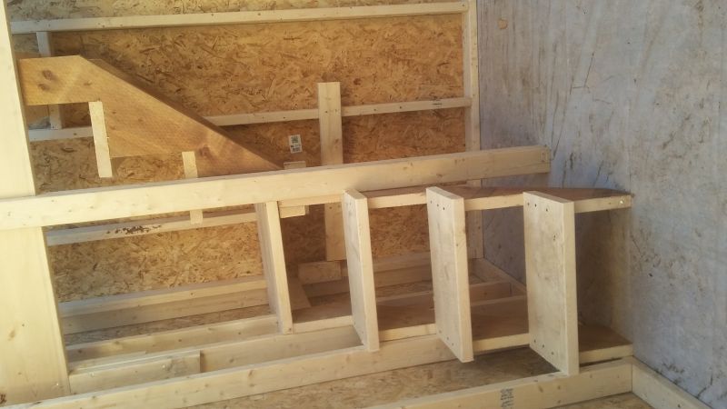

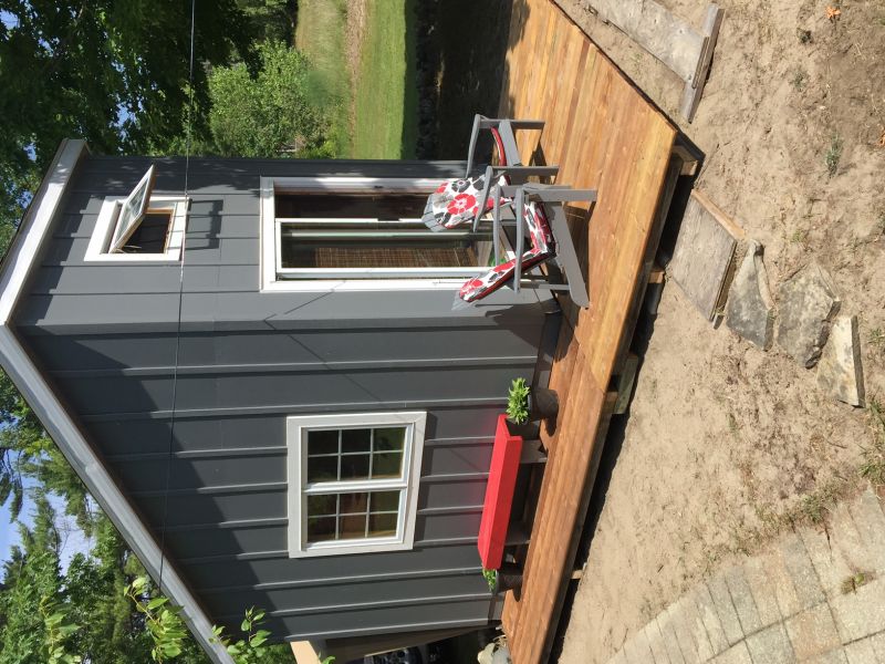

The law says 10 sq. Meters that is 112 sq ft.or 9x12 I have built 3 in the last few years .first one slept 4 with a hip roof and a second floor . It has a queen bed in the loft and a pull out couch down stairs , set of ikea cupboards with sink with a drain pail and a large bottle jug with spigot , fold down table ,2 stools , bar fridge pull out cutting board .porta potty ,outdoor bbq , full stairwell . Room to stand and dress in privet.up stairs .
Second one is very similar with a 6 12 roof .
The 3rd is just a sleeping cabin beside our large cottage for kids . It has a shed roof with a queen downstairs and two twin beds in the loft with a loft ladder.
