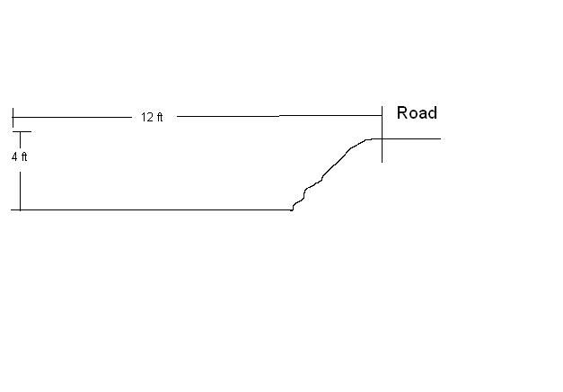

Looking for some ideas...
Our original plan for the drive we're building went south and now we're trying an alternate route that would necessitate some kind of bridge to span a ditch. Since there are underground water and electric running through there, I guess my options are limited. Also, as you can see from the crude drawing, there's about a 4ft difference in elevation from one side to the other. And since we are eventually going to bring in material for building a cabin, I guess it needs to be able to handle quite a bit of weight. And, of course, I'm looking to get something done for as cheaply as possible. Any ideas thrown my way would be appreciated.

Where is your property line in the pic? I don't think you can set half a bridge on someone else's property. I guess it depends where you are, and how many other people pass by on that road.
The road is an actual city road so they're the only ones I need to worry about. Although from what I hear, I may be able to get them to do it for me for the price of a tinhorn culvert. Not sure yet.
Thanks for the idea on the cement blocks but I just found out yesterday I can get the used utility poles from my local electric company for free. Can't pass that up.
