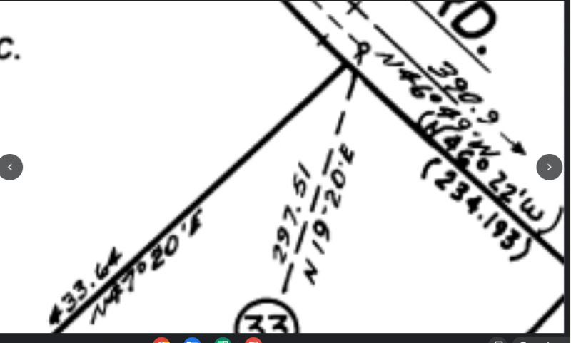

That brings up another thing.. The online parcel map shows what I think is a marker, in the road. It's not there, paved over probably a long time ago. So is the 433 ft. measured from that little circle in the pic, or from the line at the side of the road? The dashed lines measures the 297 ft. length for sure. A matter of maybe 5-10ft. from that circle to the side of the road where the solid line runs.

# Posted: 8 Jun 2022 03:54pm
What is the dashed line?
The 433' would be from the solid line, which appears to be the ROW but I don't have a big enough picture to confirm.

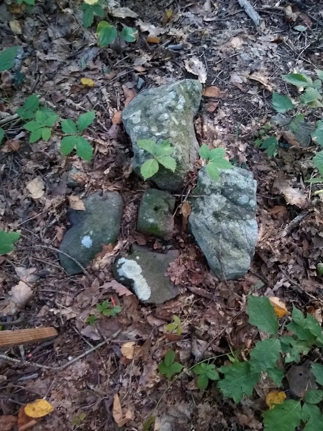

# Posted: 8 Jun 2022 04:00pm
Here is one of the "pins" I found when locating my property lines....You can always defer to your deed description to see what "should" be at your corners...... Back in the day it was a rock, tree, etc...Good times

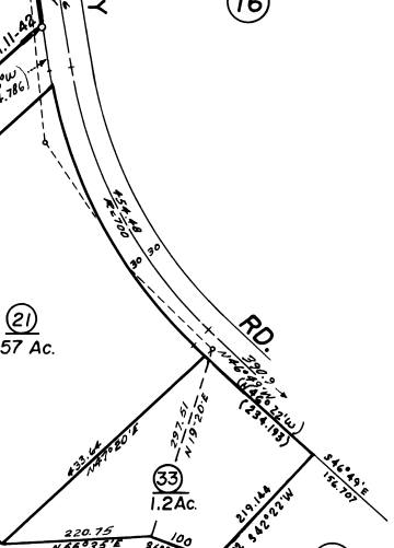

# Posted: 8 Jun 2022 08:44pm
Another pic from the county map. The dashed line runs down the street, then across that small parcel I also own. There is another circle on my lot upper right, that I guess is a marker. I have searched for it several times, it's thick in blackberry bushes in that spot, thorns everywhere, and had no luck. I think my deed does make mention of that marker.
