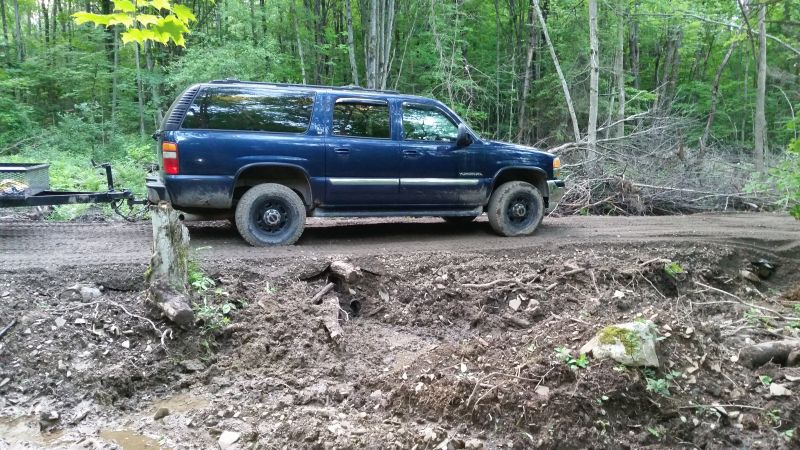

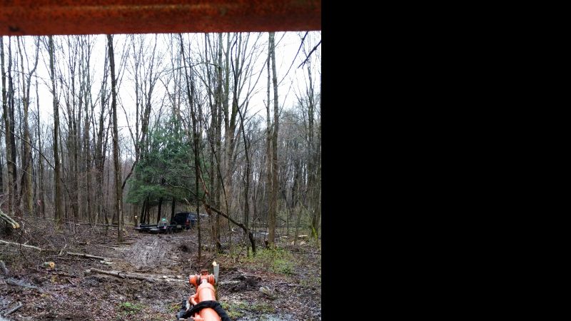

I built a driveway through a swamp. 3yrs ago and had a large stone truck on there within a month. I layed down all the logs like railroad ties, put dirt on from the ditches I dug along side the road. Then put road fabric on and 3-7in of crushed stone. The place was a complete mud pit after I covered the logs in mud/dirt. I let the surface dry out for about 3 weeks then did the road fabric/stone.
Two pics are of the same spot.
