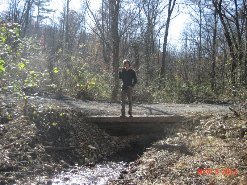

This is my third post I think, but I have been watching. I noticed that I haven't seen too much talk about roads and bridges, so I thought I would strike up the conversation. I was a little down today about the problems I have with my road which about a 1/4 mile long to get to where my cabin will be built. Also problems with my culvert/bridge.
I hired someone to widen my road based on the advice of the company that would deliver and build my cabin. The road turned out great except that I have a spring that crosses about half way down and is wiping out my road. I also discovered a second spring that is coming up out of the road. This Spring, my plan is to put in a culvert to carry the water to the other side toward the creek. Not sure how much that will cost. Also as a result of the water coming down my road which ends up turing into my bridge, the bridge is being eroded on one side. I called the contractor today and asked him to take a look at it to see if there is something he can do to fix it until we can tackle this in a few months. Can't wait until Spring! Where my son is standing is where the bridge now has a hole to the left is where the water is coming

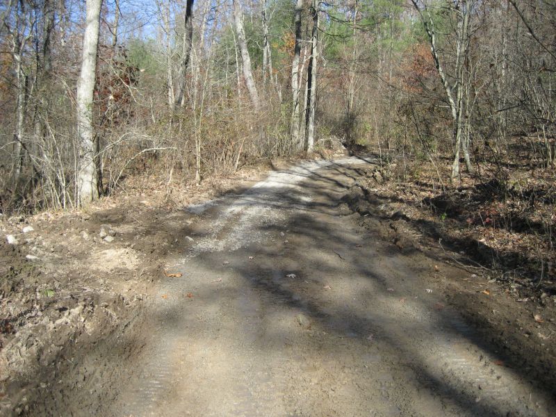

|  bottom part of this picture shows where the road is muddy, the upper part is fine

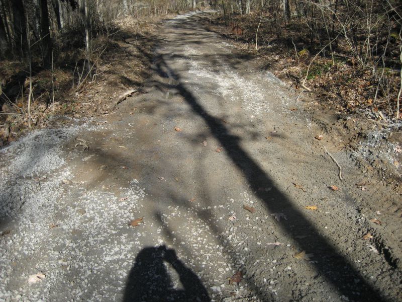

|  this picture shows my taking a pictuer of the road coming down from where the problem is

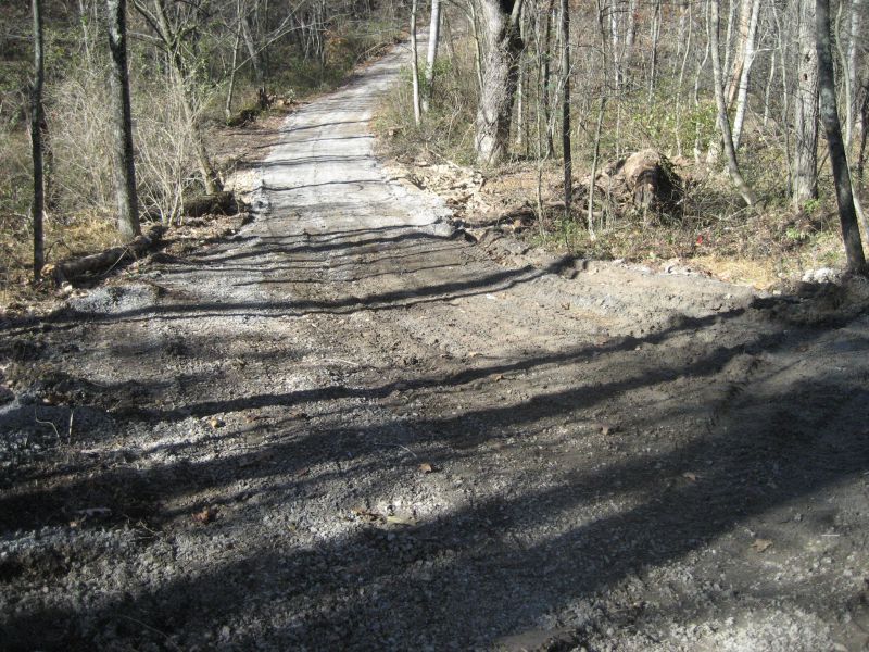

|  same

Whenever excavation of any kind takes place consideration to the possibility of erosion should take place , Your contractor should have advised you of the risks.. all kinds of things could have been done at the time of excavation to prevent the damage you have. IT is never to late to start . not knowing your location I hesitate to be specfic. but you need to get something to cover the loose earth and some native seed to start growing to stabilise the earth.

Cabingirl, you need to get a shovel and dig a ditch to carry the water away from where it's eroding your road. This needs to be done asap to minimize the erosion. Where it's softening your road, dig a drainage, drain the water away. You have to observe this while there is standing water on the ground. It might solve the problem but be ready to buy more rock if it doesn't solve the problem.
The way you did it, "just get it done" at less cost, is an OK method and many roads are done like that. With that cost savings your current job is to observe, and let the trouble spots make themselves apparent by using the road and pay special attention to it IN THE RAIN.
It looks like you'll have to raise the roadbed 5-10 inches with larger rock in that soft area. Your roadmaker can come back and add more rock, and you will certainly have to pay for it. At least you now know where the problems are. You only have to address the trouble spots, which probably costs less than doing the whole road like that. Your roadbuilder will know a lot more too seeing it while it's wet. You may need a culvert. You may have to put some fabric down. Doing it this way might be better than buying a culvert and never seeing a drop of water go through it. This is normal for a new road.
