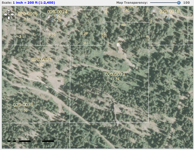

Are you in USA? If yes, go to your county website, look for "assessor". You are looking for plat maps that show your parcel, and ideally show it laid ontop of a satellite photo. Not all county websites have this, and also there can be error in the placement of the photo.
If you can find those, copy a screenshot of the image, and if there is photo detail then you can look for pins. Zoom into the corners and make screen prints. Certainly the road and railroad will appear prominently on the satellite photo. Corner section is good (if it's not the one in the river). My place has pins on some 16ths but has a BIG pin at the section corner. Satellite photo with property lines
