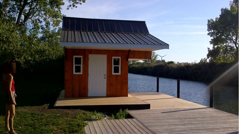

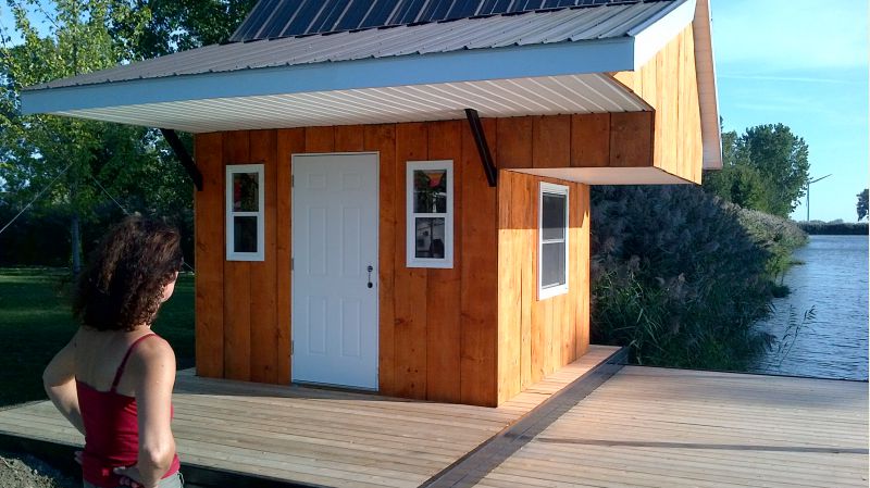

I have gone down that road with my Township in South Western Ontario and I have built, with a proper building permit from the Lower Thames Conservation Authority, a 108 squ.ft. base shed with a 10 x 16 ft loft. It is legal and conforms to all laws. I then added some supports to the front of the building to add strength to the building and I have yet to hear from anyone about this. I was told by the LTCA that I could not add these supports so I built it without them, only to read my Building Code book for long hours trying to find a clause that would prevent me from adding supports. I couldn't find one anywhere.
And so my building has a 6 ft overhang at the front and I'll wait to see what becomes of this move. I would take it to court if they request I remove the supports. My argument being that I have no intention of closing this area in and I should not be proven guilty for something I haven't done. I don't drive my car into people even though I could and I won't close in this space even though I could.
For me, the second floor is not recorded or measured because it is less than 6 ft 6 inches in height which is the minimum height for a second floor. Mine is 6 ft in height.
I cannot find anything that tells me this can't be done. The exterior of walls are measured to determine the 108 squ.ft. size, not the interior walls, and I conform. They can't use supports to define a wall and in my case, I'm on a dock. IMG_00000447.jpg

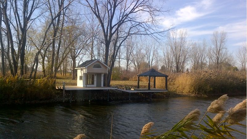

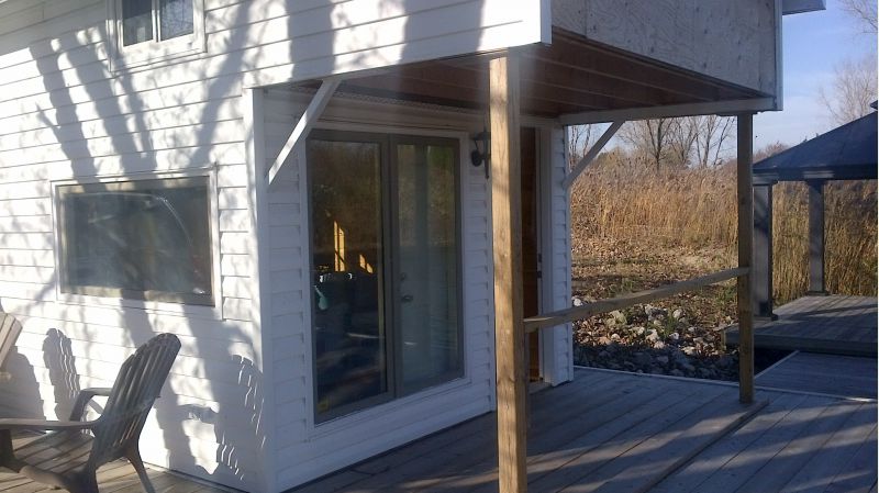

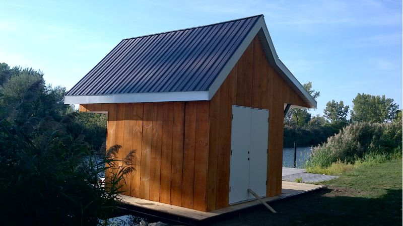

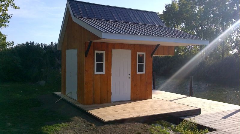

Have a look at my freinds place, he followed my advice and built this shed. It has a loft and plenty of room in the roof area. This build required a permit for the dock but the shed doesn't require anything. Note: This shed has a 2 x 4 inch steel structure for the whole thing and is then clad in wood and siding. All steel to the dock.
