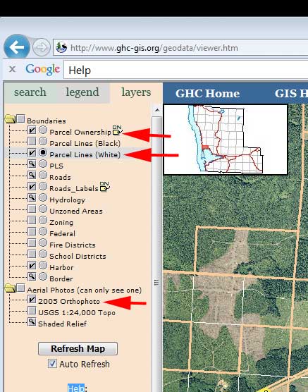

Greenacarina, your parcel# does not come up as 'valid' parcel# on http://www.ghc-gis.org/geodata/viewer.htm . It could be because the county website is malfunctioning at the moment, but you can try it yourself. Look for parcel# "search". Also you might go back and 'edit' your post, to DELETE the parcel# from the internet. grays harbor GIS example, with aerial photo layer and parcel lines layers turned on.

Oops!! Maybe it was late at night, or I just have fat fingers. Should have been 75 at the beginning and not 57. I edited it out of my previous post as well. Here is the correct stuff- http://www.ghc-gis.org/geodata/viewer.htm?Query=Parcelatt='752000300200'&QueryZoom=Ye s
