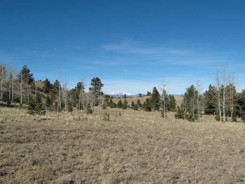

 And for all those curious folks out there property is in Colorado near Hartsel (area known as southpark) at roughly 8500 feet elevation.  High mountain vegetation, pines, aspens, firs, and brush although the brush and aspens took the drought hard this year and I expect to lose a lot of it.
