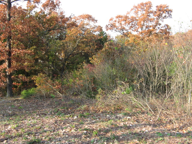

 What I am dealing with.  Over to the left has been cleared.  In the center trees/brush has been cut but not yet hauled off.  To the right is area remaining to be cleared.  The stuff is 6 or 7 feet tall, with a few trees of 8 or 9 feet.

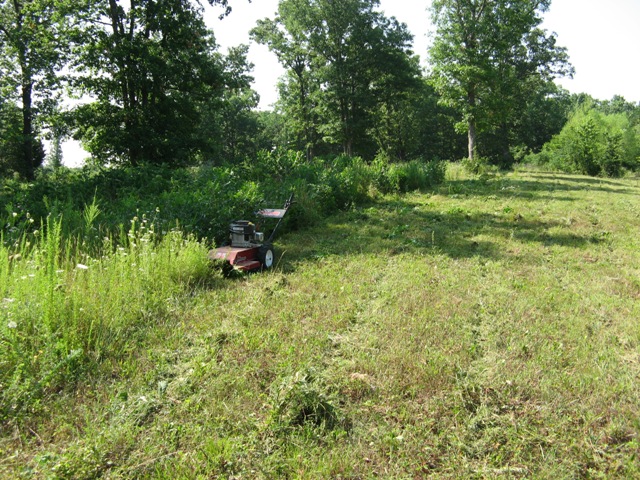

 The walk-behind field & brush mower.  This is a Swisher.  It will set you back about $1350.00 plus sales tax and/or shipping.  DR makes several, all of which cost more.  So does Billy Goat.  I have used & abused this machine for 2 summers now, and have no complaints about it.  Currently have it torn-down to replace belts.

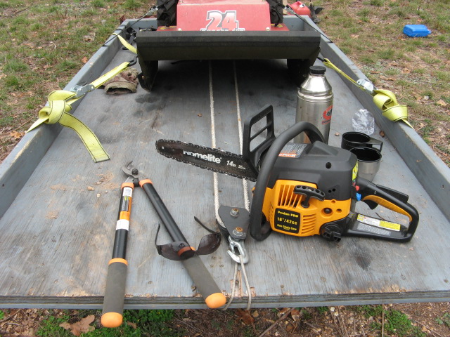

 The 4 essential tools of brush clearing:  branch loppers (capacity 1.5 inches), 18 inch 42 CC chain saw (fitted with 14 inch bar & chain in this photo), and the walk-behind field & brush mower.
 4th "essential" is vacuum bottle of coffee.
 Trailer is modified boat trailer with 4 ft by 8 ft plywood bed added.
 Note safety glasses.
