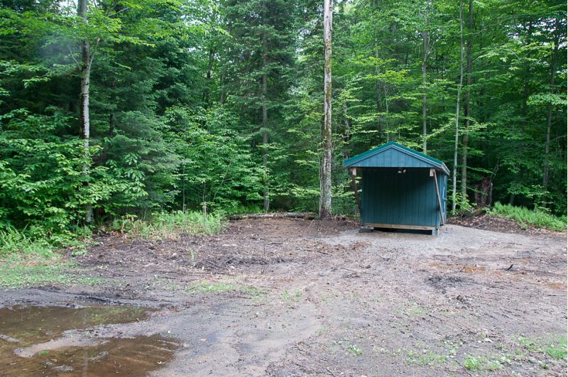

Sure. This is a picture of our shed that will hold the water tank and solar batteries. To the left of this shed is where the well is getting ready to be drilled.
Prepare for well and utility shed

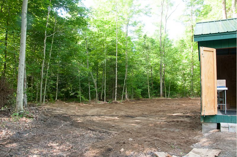

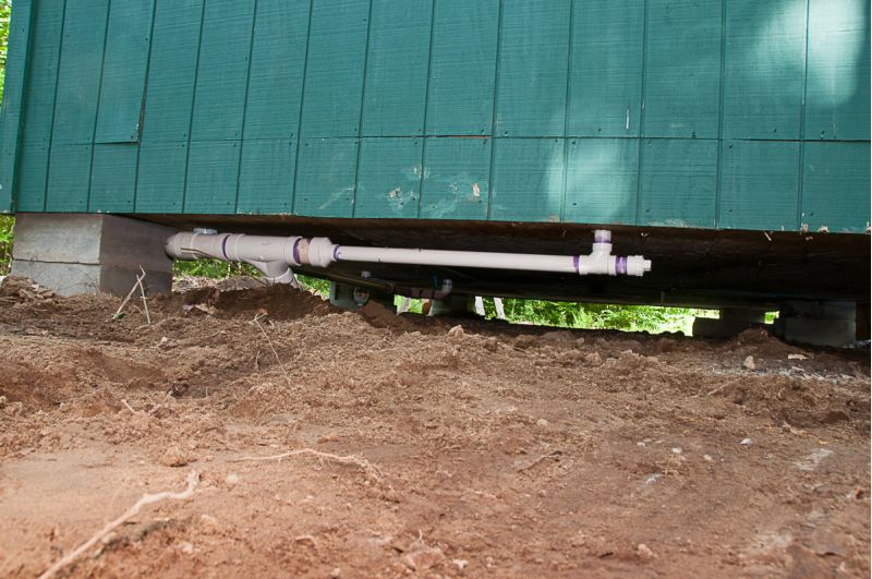

With small children, I had to put in a septic tank and small bathroom.

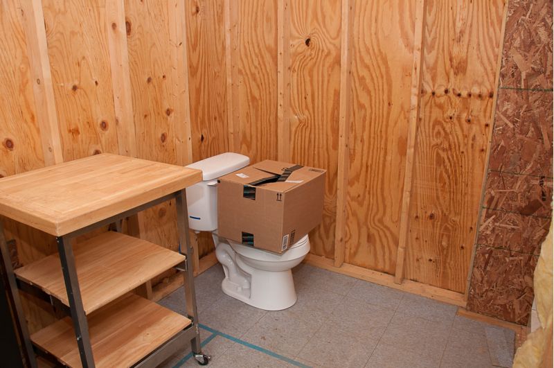

This is the location for the toilet. The blue tape on the floor will allow me to put up a wall with barn-style doors. We also have a small sink and installed a propane-powered instant hot water heater. Worked out great for us.

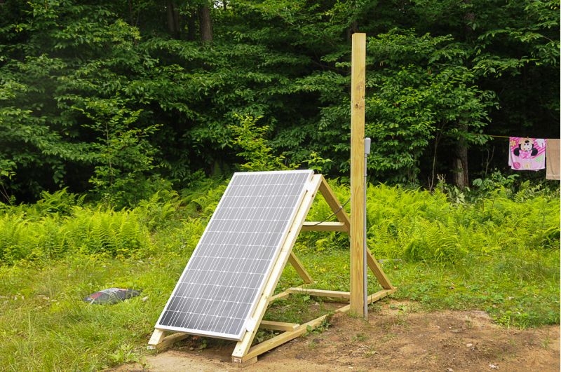

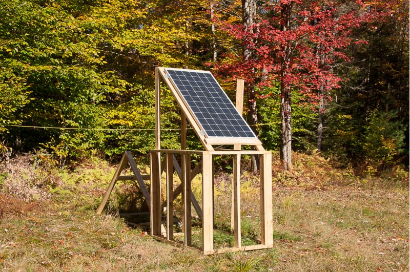

I installed one solar panel to power my DC well pump to draw the water out of the well into the pressure tank. The panel is temporarily on the ground just so I could make sure everything worked. In the 2nd picture, I properly mounted it off the ground before the winter came.

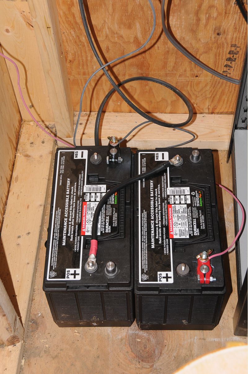

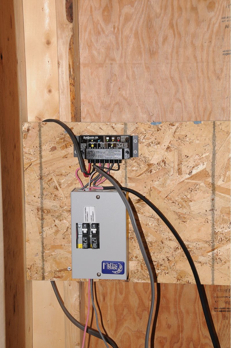

I just have 2 circuit breakers. One to shut off the solar charge to the batteries and the other to shut off the pump. When I am not up there, I turn off just the breaker for the pump and the other remains on to trickle charge my batteries. This is a 24v system and as I had said, it is enough to power my pump. Even on cloudy days, the batteries never drain down.

Beautiful property, I really like your creek! A couple of questions: how deep is your well and what is the manufacturer and specs on your solar well pump?
DackRetreat
# Posted: 12 Dec 2016 09:23pm - Edited by: DackRetreat
Thanks. That was the main reason I purchased the property. The kids have a blast wading in the ice cold water, which makes it all worth it . The well is 130 feet deep with static water level at 70 feet. I have the Shur-Flo 9300 DC pump. I believe it can handle 2 gal/min.
