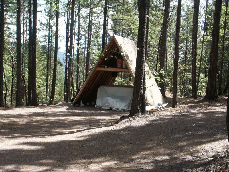

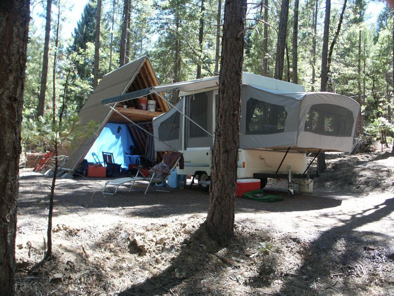

I need to do this before winter, do you have a picture of your small shed? How do you have it anchored to the ground? Thanks
# Posted: 10 Aug 2014 10:29 - Edited by: bldginsp
Here's pics and original design plan of my A frame. I built it the first summer to keep the snow off my trailer, cause snow destroys RVs. True to form, that winter there was a 4 foot snow. There are 12 precast piers on grade. They are the type of pier that has straps in them. On each pier I placed one brick between the straps, and ran a 4x6PT sill on top of those bricks. The bricks just elevate the wood off dirt a bit more. On top of the 4x6 sit my pole rafters cut on site, then plywood, flashings, 30lb felt, etc. Horizontal ceiling rafters/collar ties give it strength and make a little attic for storage.
It is only anchored to the ground with the piers, which are not set in concrete, that's partly why I used 12. The straps are nailed to the 4x6 sills, and the plywood is nailed to the sills, so the structure is well tied to the piers. Wood block precast piers don't give you anything to tie to except toe nails. The wind would have to lift 12 piers to topple this building, which I think is possible but highly unlikely.
I put roll roofing on it at first because it is cheap and fast, since then I have covered it with metal roofing and walled in the ends with doors and a window. Roll roofing wont last more than a few years in a snow environment, but it was a good temporary solution.
There are forest frogs (toads?) that live in it now, they relish the water I spill when I am there. Mice inhabit insulation stored in the attic, that is, the ones I haven't caught in my Hav-a-hart yet.

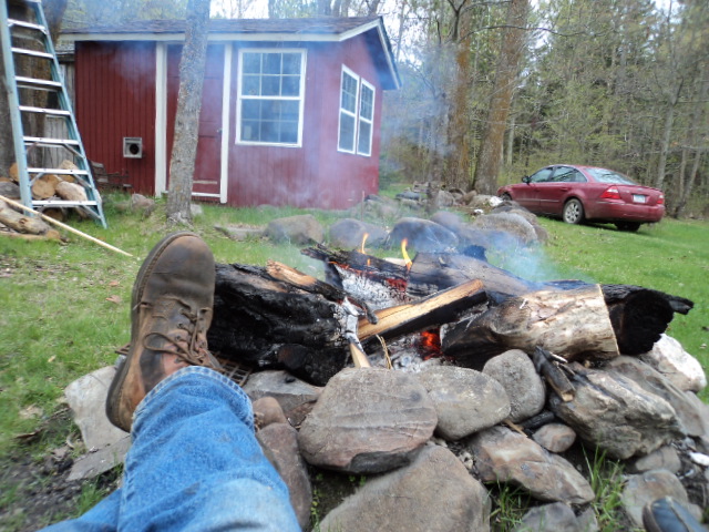

Extra bunk houses are great. You can keep them clean and closed when not in use. Guests and kids like to have their own sleep area. You can all get together at the dinner table or camp fire. Here's mine.
