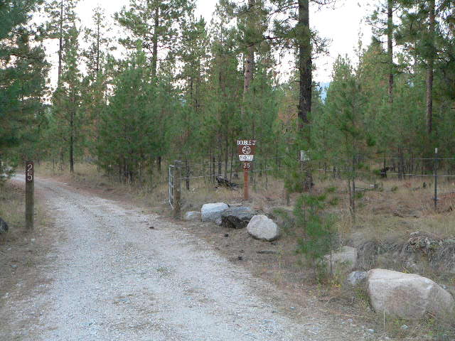

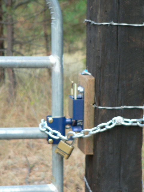

My main entrance was 12 foot, if I had to do it over, be 16 footer. My new 20 next to my existing 20, I use the 16 foot gate and a real cool cattlemans latch, set to open either inward or outward.
12 foot cattlemans gate, main entrance
16 foot cattlemans gate, new 20 acre lot
Cool cattlemans latch
