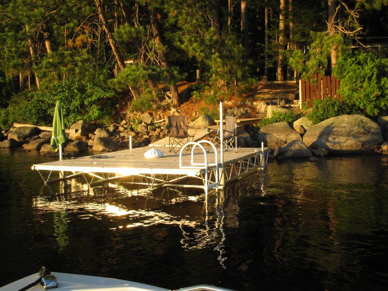

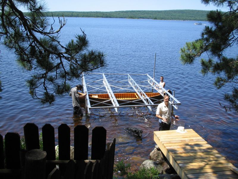

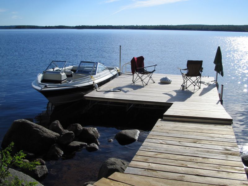

Our dock is 12 x 16 and can seat 10 pretty comfy, up to 16 if needed. I had to build the cedar planking - 8 pieces each 2 x 12. One person can install but it is a pain. Nice when it's set up. I take off the decking one piece at a time and stack it in the woods for next year. Then I raise the aluminum frame and float a canoe under it, lower the frame and take it down the shore and remove the legs and drag it away from the water for the winter. Beats having the ice crush it. I''ll send along a pic or two when I find them.
beachman
# Posted: 21 Jan 2015 08:00am
OK - here are a couple of pictures of putting in the dock with a canoe and the final product set up. I built the first part out of hemlock before the ramp starts and it is very heavy. I take this out too and move it up on the rocks. It is nice to have but is a lot of work to take in and out - but necessary due to the ice.
